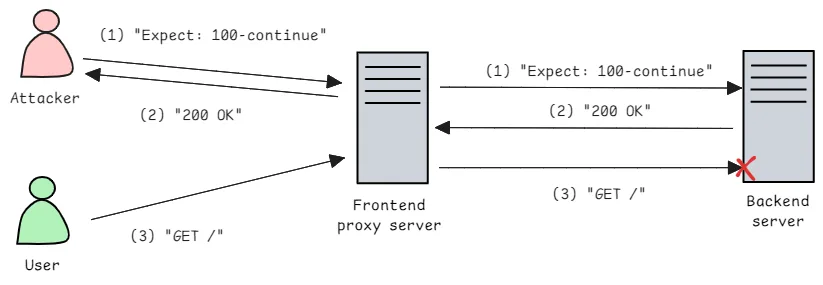

An attacker sending a request to a net/http/httputil.ReverseProxy proxy can exploit this mishandling to cause a denial of service by sending "Expect: 100-continue" requests which elicit a non-informational response from the backend. Each such request leaves the proxy with an invalid connection, and causes one subsequent request using that connection to fail.
In simpler terms: You have a Go-based frontend proxy server and an arbitrary backend it connects to. (1) An attacker sends an Expect: 100-continue request to the frontend, which forwards the request to the backend. (2) The backend responds with something other than a 100 Continue response, leaving the connection in a bad state. (3) When an unsuspecting user then issues a request to the frontend, the bad connection gets reused, the request misinterpreted, and the user left without a response.

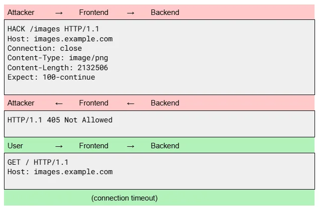

Using the non-standard verb HACK to coerce an nginx backend, the full protocol-level attack flow against our image service example becomes something like this:
Why does the connection time out? Because the backend server is expecting a 2132506-byte request body, but instead only gets a short GET request in its place. It’s left waiting for the rest of the bytes.

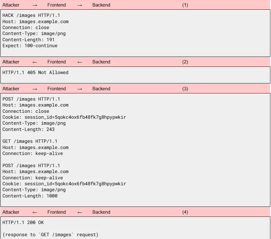

Below we have another example of an exchange with our image service:
Although the attack is technically simple, there are a lot of moving parts. So let’s go through the example step-by step.
(1) The attack starts with the request HACK /images, used to “elicit a non-informational response from the backend.” (2) Desynchronization happens, as the backend responds immediately with a final status and the frontend omits sending any request body.
(3) Next, the attacker starts manipulating the connection state by sending a request whose body consists of two other requests. First in the body is a GET request whose only job is to ensure that (4) the backend responds to this combination of requests and the frontend-backend connection remains alive. Second is a POST request with a sufficiently large Content-Length header value, but no request body. This is a request to upload an image using the attacker’s credentials.

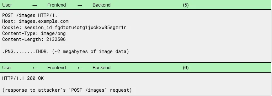

After (3) and (4), the connection is left in a state where the backend expects a body for a POST request, but the frontend expects a new request. (5) When an unsuspecting user then issues a new POST request to the frontend, the frontend-backend connection previously manipulated by the attacker is reused and the backend interprets the request headers as part of the attacker’s request body. The user’s session cookies are uploaded as the attacker’s image file contents, and, finally, (6) the user sees a response intended for the attacker.
This specific attack allows stealing session cookies from other users, but other variants of the attack may allow a wide range of impacts from stealing other types of secrets to injecting malicious responses, and indeed also denial of service.
