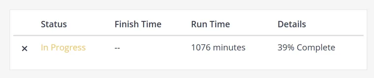

However, I recently tested something I haven’t tried in a while: indexing a fairly large database (with 100 million posts) completely from scratch. When the database is already indexed, subsequent indexes of new posts and files are quite fast, so the normal usage of Elasticsearch is flawless, but an index from scratch is slow:
This screenshot is our job system informing us that the Elasticsearch indexing job has been running for around 18 hours, and hasn’t even finished half of what it needs to do 🙁 And the progress was not linear, slowing down more and more the further it progressed! Something was clearly wrong here.

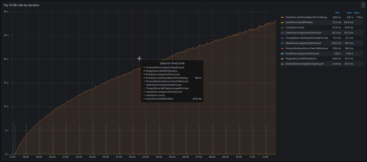

Let’s start the investigation by identifying what exactly is slow here, since there are many moving parts: it could be the database, the Mattermost server, the Elasticsearch server, the network, or an under-resourced machine.
Looking at our Mattermost Performance Monitoring Grafana dashboard while the indexing job was running, the problem was crystal clear at first sight:
The graph above shows the top 10 database calls by duration, which comes down (simplifying it a bit) to the following Prometheus query:
topk(10,
    sum(increase(mattermost_db_store_time_sum[5m])) by (method)
    sum(increase(mattermost_db_store_time_count[5m])) by (method)
We measure the time it takes for each database method to finish, averaged over the last 5 minutes, and we plot that by second, showing only the top 10 methods.
And looking at the graph, there’s a clear outlier there: PostStore.GetPostsBatchForIndexing, which is taking more and more time as the indexing job progresses, eventually hitting the 30 seconds mark, when it simply times out. Looking at the code, we see the exact query that’s causing all these problems:

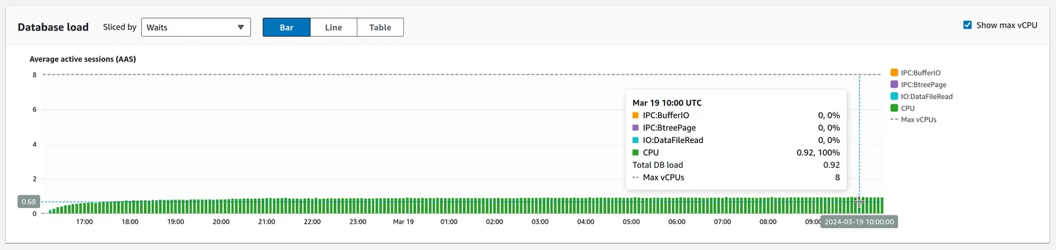

My first concern with this query was: why on earth does it take longer and longer each time it gets executed? The answer was actually pretty simple, but I had no idea at the beginning. So the first thing I looked at was the data I already had at hand: the AWS Performance insights of the query:
This gave me the first clue: the query spends nearly 100% of its running time on CPU. This means the query is not bottlenecked by the time it takes to read or write data, but by the time it takes to process that data. Interesting.
