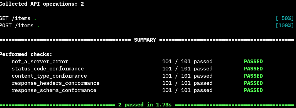

We can get a feel of Schemathesis at this point by executing the test in a separate terminal using the following command:
schemathesis run --base-url=https://localhost:8080 openapi.yaml
The command runs the tests against the OpenAPI schema we defined earlier by making HTTP requests to the base URL we specified and produces an output similar to the one below:
Schemathesis success output following a basic test
While none of the endpoints is implemented yet, the output above reports Schemathesis as successful. This is because, by default, it only checks that the application doesn’t crash with an internal server (HTTP 500) error for different kinds of inputs. Schemathesis provides five different check types:
  1. not_a_server_error checks that the application doesn’t return a HTTP 5xx error for any endpoint (unless it is explicitly defined for such).
  2. status_code_conformance checks that the HTTP code returned by the application matches what is defined in the API schema.
  3. content_type_conformance checks that the HTTP content type returned by the application is defined in the API schema.
  4. response_headers_conformance checks that all headers present in the actual response from the application is defined in the API schema.
  5. response_schema_conformance checks that the body of each response matches what is defined in the API schema.

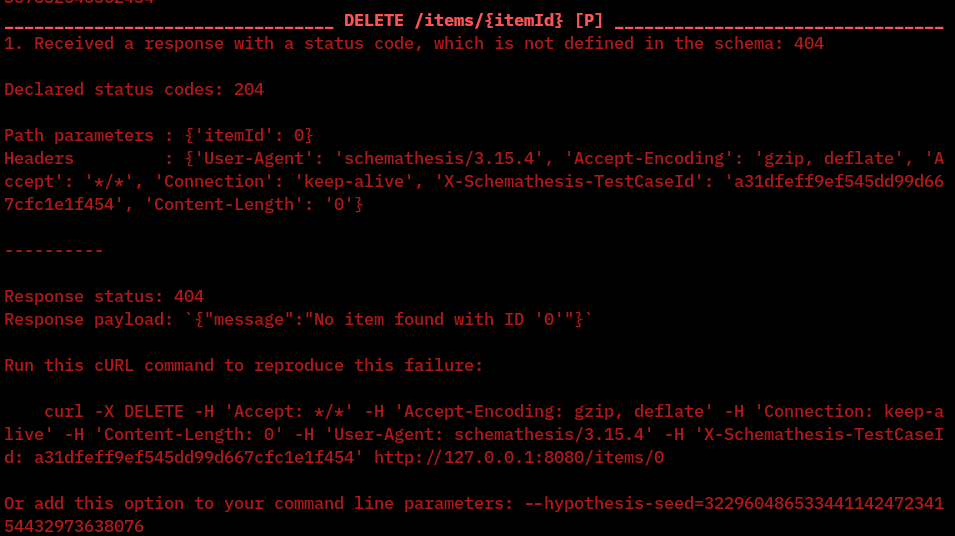

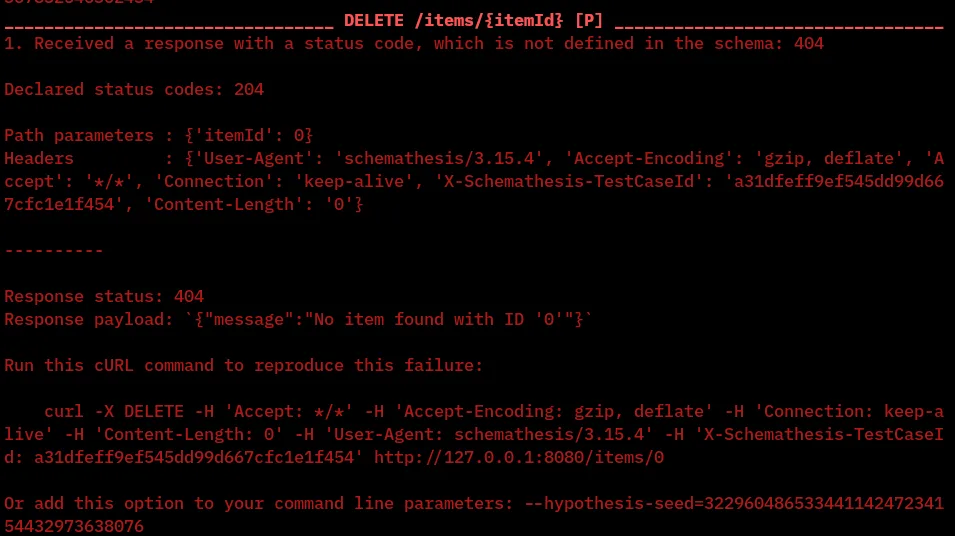

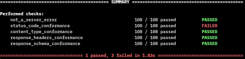

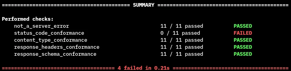

Let’s re-run the tests with all of these checks enabled using the command below:
schemathesis run --checks=all --base-url=https://127.0.0.1:8080 ./openapi.yaml
This time, the test fails with a summary similar to the screenshot below.
Schemathesis error output after enabling all checks
In the screenshot above, no endpoint passed the status_code_conformance test because our server currently returns a HTTP 404 error for all endpoints. Since we are yet to specify what a 404 error should look like in the schema, Schemathesis assumes that the response structure is correct and marks the other tests as passed.
Now that we have failing tests, let’s work to make them pass by providing an actual API implementation.

Debugging test errors
With the API up and running, you can run Schemathesis (with all checks enabled) against the API URL using the same command from earlier:
Again, this fails with the summary below even though we’ve already implemented all the endpoints.
Schematheis error output after implementing endpoints
Looking closely at the output, though. We notice that the number of tests has dramatically increased (from 11 to 108). This is because as Schemathesis gets a success response, it further varies the inputs to cover more edge cases. We also notice an error similar to the one below:
This happens because our endpoints return HTTP responses (e.g., 404 for missing items) that we still haven’t defined in the API schema hence, our tests fail the status_code_conformance check again.
To get the test to pass, update each endpoint response with the possible errors it can return. As an example, here’s what the GET /items path looks like after the change:

Re-run the tests with:
This time, you should get an even more number of tests, all of which are successful as shown in the screenshot below:
