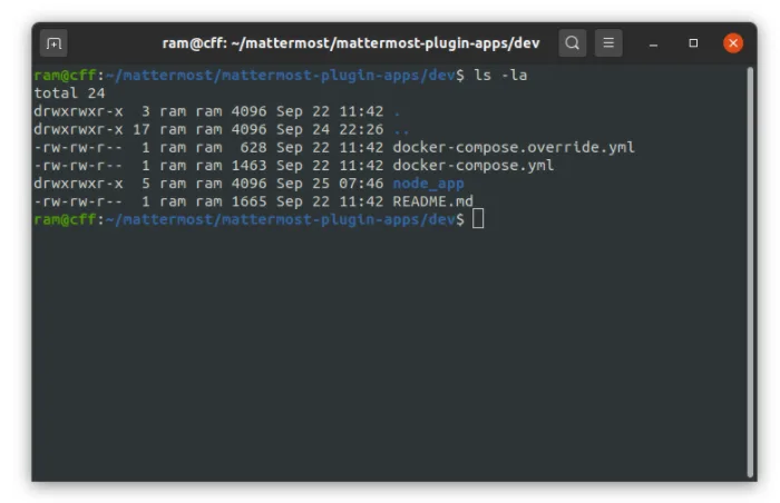

Once that’s done, change the directory to the dev folder.
There should be a folder named node_app, a docker-compose.yml file and a couple of other files (used for housekeeping).
cd dev
ls -la
Get Started with Mattermost Apps Image 1

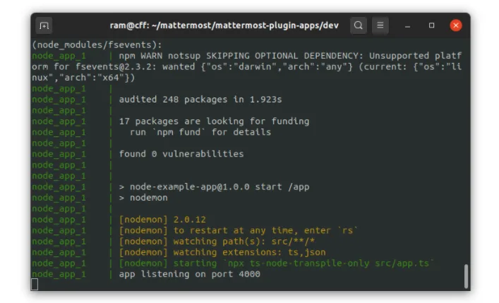

Run the Docker compose file to spin up the containers
docker-compose up
The following output on your terminal will indicate a successful run:
Getting Started with Mattermost Apps Image 2

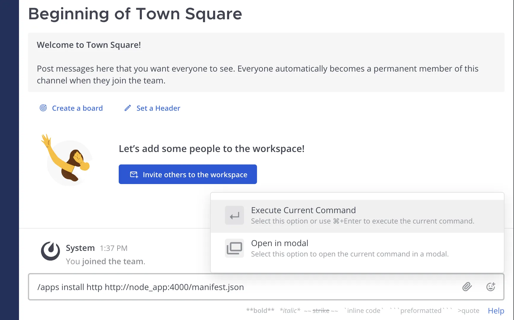

In the default channel, install the node_app test app using the following command:
/apps install http https://node_app:4000/manifest.json

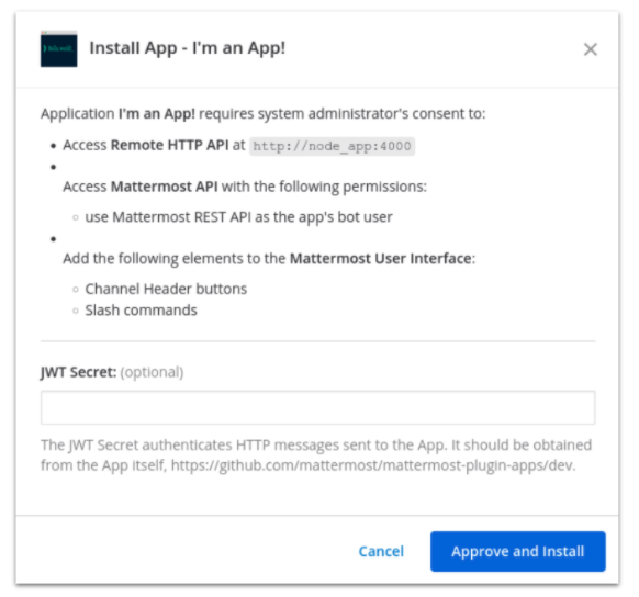

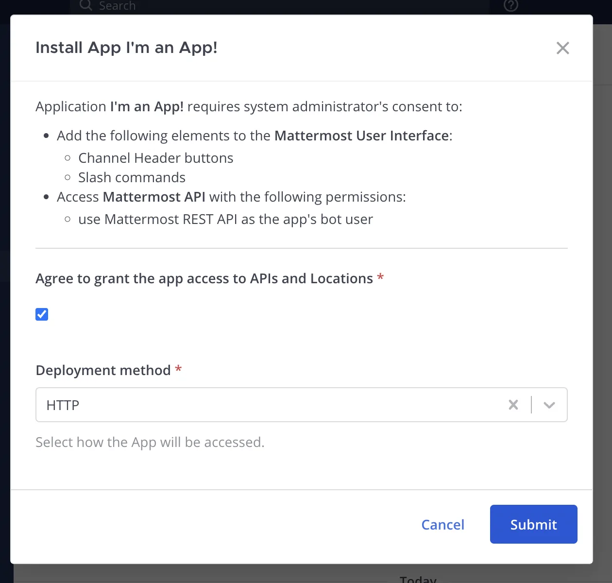

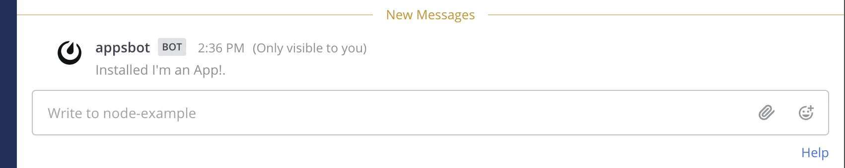

Paste the above install command into the input chat box at the bottom of the browser. This will bring up a dialog.

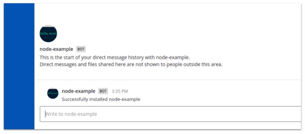

Complete the installation by clicking the Submit button. Once installed, you will receive a system-generated confirmation message from appsbot.
