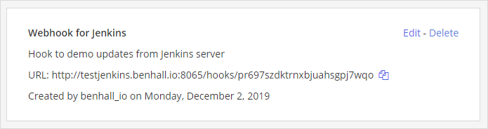

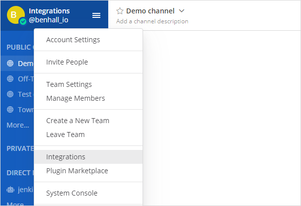

To add an incoming webhook on your Mattermost server, go to Main Menu > Integrations > Incoming Webhook > Add Incoming Webhook.
If the menu option for integrations is missing, direct your admin to this guide to enable it.
You’ll end up with a URL generated for you, ready to send data to and from Jenkins:

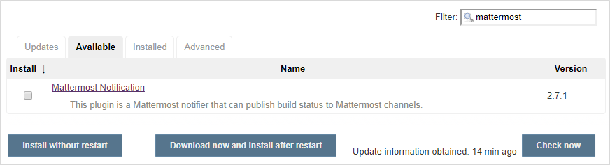

Next, install the Mattermost Notification Plugin on your Jenkins server through the Plugin Manager UI:

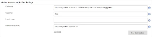

Now configure the Mattermost webhook endpoint on your Jenkins server.
From the Jenkins dashboard, go to Manage Jenkins > Configure System > Global Mattermost Notifier Settings and paste in the endpoint URL generated by the Mattermost server for the incoming webhook you added.
You’ll need to include the Jenkins build server address for any links back.

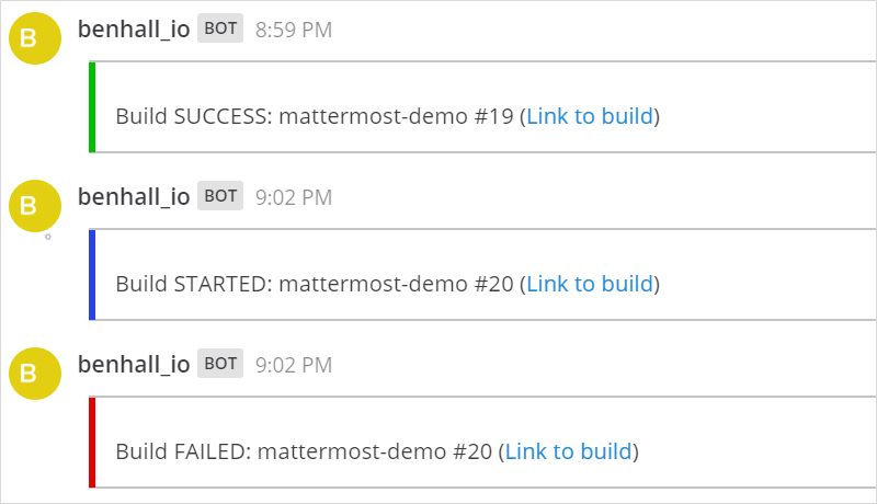

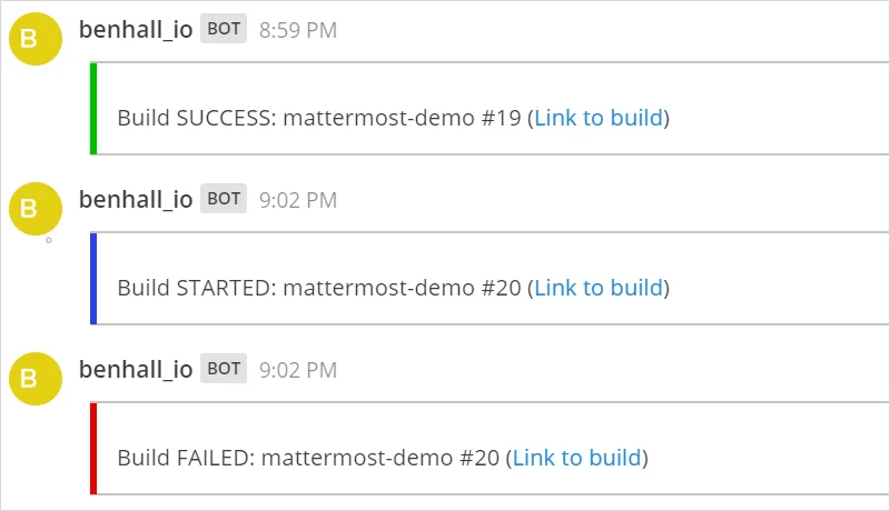

In the configured channel on your Mattermost server (assuming a successful first run of the build was followed by a failed run), this is what you see:
Note that all senders from external apps are labeled as bots by default to help protect users from phishing attacks.

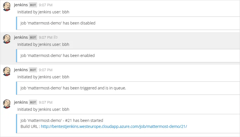

Now, connect to Jenkins from a Mattermost channel. The Jenkins plugin provides a range of slash commands that enable interaction with Jenkins jobs.
A full list of commands can be seen here or by typing the slash command:
/jenkins help
The first command you need to execute to get connected is:
/jenkins connect username API_Token
Then you can start a build with:
/jenkins build mattermost-demo
At this point, you’ll see this:
