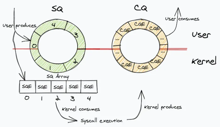

Fortunately, there’s an age-old solution to this problem: ring buffers. A ring buffer allows efficient synchronization between producers and consumers with no locking at all. And as you might have already figured out, we need two ring buffers: a submission queue (SQ), where the user acts as the producer and pushes syscall requests, and the kernel consumes them, and a completion queue (CQ), where the kernel is the producer pushing completion results, and the user consumes them.
With such a model, we have eliminated any memory copies and locks entirely. All communication from user to kernel can happen very efficiently. And this is essentially the core idea that io_uring implements. Let’s briefly dive into its internals and see how it is actually implemented.

To push a request to the SQ, we need to create a Submission Queue Entry (SQE). Let’s assume that we want to read a file. Skimming over a lot of details, an SQE will basically contain:
  • Opcode: An operation code which describes the syscall to be made. Since we are interested in reading a file, we will use the readv system call which maps to the opcode IORING_OP_READV.
  • Flags: These are modifiers which can be passed with any request. We will get to it in a moment.
  • Fd: The file descriptor of the file that we want to read.
  • Address: For our readv call, it creates an array of buffers (or vectors) to read the data into. Therefore, the address field contains the address of that array.
  • Length: The length of our vector array.
  • User data: An identifier to associate our request when it comes out of the completion queue. Keep in mind that there is no guarantee that the completion results will come out in the same order as SQEs. That would defeat the whole purpose of having an async API. Therefore, we need something to identify the request we made. This serves that purpose. Usually this is a pointer to some struct holding data that has metadata of the request.
On the completion side, we get a Completion Queue Event (CQE) from the CQ. This is a very simple struct which contains:
  • Result: The return value from the readv syscall. If it succeeded, it will have the number of bytes read; otherwise, it will have an error code.
  • User data: The identifier that we had passed in the SQE.
There’s just one important detail to note here: both the SQ and CQ are shared between the user and the kernel. But whereas the CQ actually contains the CQEs, for SQ it’s a bit different. It is essentially a layer of indirection wherein the value of an index in the SQ array actually contains the index of the real array holding the SQE items. This is useful for certain applications which have submission requests inside internal structures, and therefore allows them to submit multiple requests in one operation, essentially easing the adoption of the io_uring API.
This means we actually have three things mapped in memory: the submission queue, the completion queue, and the submission queue array. The following diagram should make things clear:
Now let’s revisit the flags field that we skipped over earlier. As we discussed, CQE entries can come completely out of order from what they were submitted in the queue. This brings up an interesting problem. What if we wanted to perform a sequence of I/O operations one after the other? For example, a file copy. We would want to read from a file descriptor and write to another. With the current state of things, we cannot even start to submit the write operation until we see the read event appear in the CQ. That’s where the flags come in.
We can set IOSQE_IO_LINK in the flags field to achieve this. If this is set, the next SQE gets automatically linked to this one, and it won’t start until the current SQE is completed. This allows us to enforce ordering on I/O events the way we want. File copying was just one example. In theory, we can link any syscall one after another, until we push an SQE where the field is not set, at which point, the chain is considered broken.
