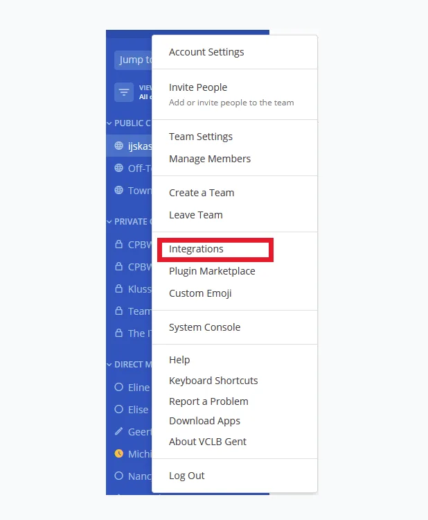

1. Go to the Menu and choose Integrations:

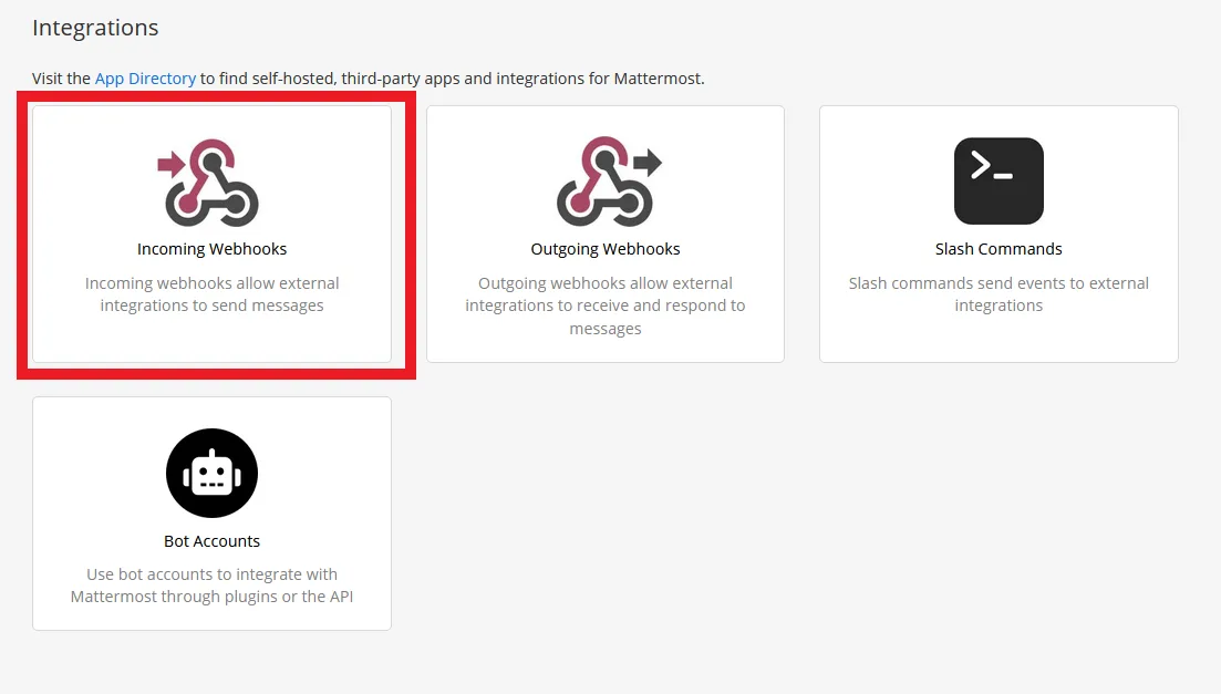

2. On the following screen, choose Incoming Webhooks:

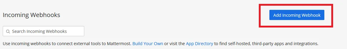

3. On the next screen, you can see your existing incoming webhooks and add a new one.

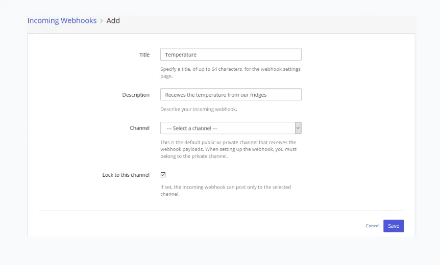

4. Now, you can set up the incoming webhook in five simple steps:
Incoming webhooks
  1. Give the incoming webhook a title
  2. Give the incoming webhook a description
  3. Select the default channel that receives the messages that the incoming webhook is sending
  4. Choose if you want to lock the incoming webhook to the channel or that it is allowed to send to other channels as well
  5. Click the save button
See, that wasn’t that hard. You get a confirmation with a very important URL, which listens to the messages we will be sending.

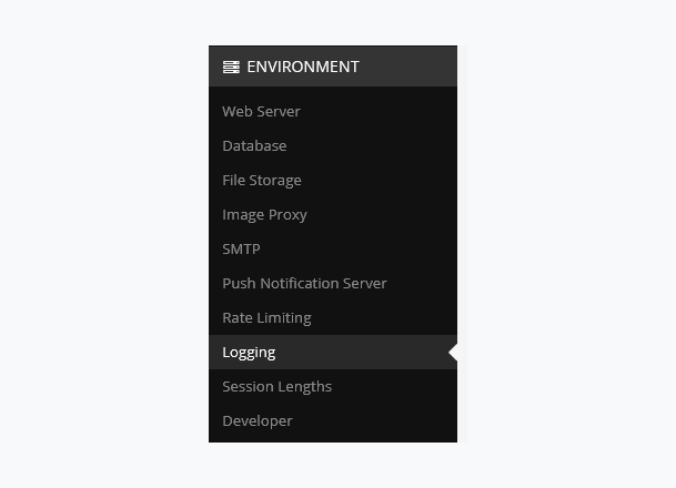

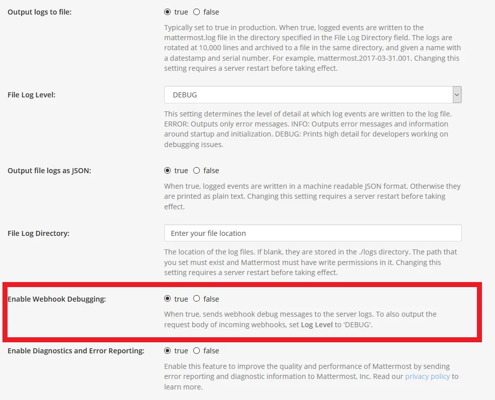

Is something not working as expected? Go to the System Console and click on Logging under Environment.
In the Logging section, enable Webhook Debugging and set File Log Level to Debug.
You’ll find all the relevant information you need in the logfiles (or in the console if you enabled logging to the console).
