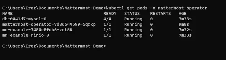

5. Wait for the pods to spin up. You can press CTRL+C to exit the command at any time.
minikube kubectl get pods -n mattermost-operator -w
After a few minutes (depending on internet speed and hardware) you should be able to see the following result.
mattermost on minikube
