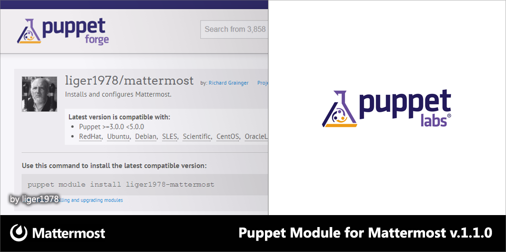

So far the Puppet module has been tested successfully on Enterprise Linux 6 and 7 (that is: RHEL, Scientific Linux, CentOS and Oracle Linux); Debian 6, 7 and 8; SLES 12; and Ubuntu 12.04 – 15.10.
Puppet Module for Mattermost deploys Mattermost to RHEL 6, 7; CentOS 6, 7; Oracle Linux 6, 7; Scientific Linux 6, 7; Debian 6, 7, 8; Ubuntu 12.04 to 15.10 and SLES 12

Try the Puppet Module for Mattermost
That is probably enough to give you an idea of what you can achieve with the
module. If you want to learn more or give it a try you can find the Puppet module with
full documentation on Puppet Forge.
If you want to contribute you can find the code on GitHub (pull requests welcome!)
