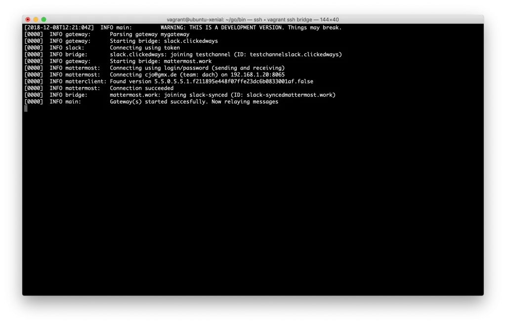

Now that Matterbridge is configured, start it up:
./matterbridge

Matterbridge output
/matterbridge output

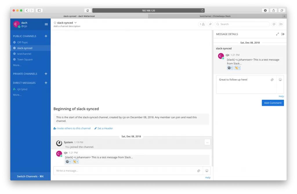

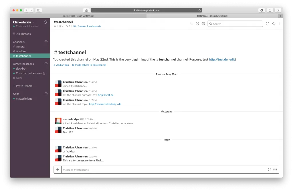

Everything written in a Slack channel should now be visible in a corresponding Mattermost channel. You should be able to search for and comment on existing conversations that originated on Slack.
Slack channel view
 Slack channel view
The “RemoteNickFormat” can be customized in the configuration file to meet your unique requirements.
Mattermost synced message
