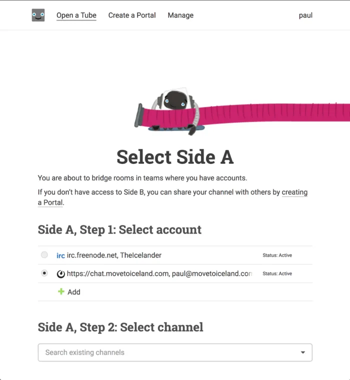

Sameroom is a SaaS product that will connect a lot of different chat programs to a lot of other ones, including IRC and Mattermost. To set it up, you need to register your various accounts and then set up “tubes” between them.
Sameroom
Setting up a tube in Sameroom.
Once you have the tube set up, Sameroom will transmit messages in real time based on your configuration settings.

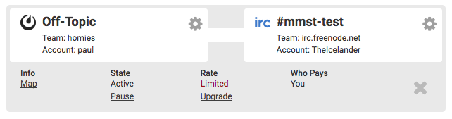

The Tube configuration page will let you see the status of your tubes.
Mattermost-IRC
A configured tube on Sameroom.
Sameroom gives away a single tube with five messages a day for free; unlimited plans start at $49 per month for five tubes. If you have more than a few IRC channels, it can get pretty expensive.
