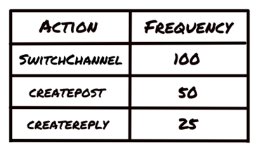

This means we’re able to continuously collect a considerable amount of realistic metrics from our community servers. We can then use such data to model user behavior. To do this we create a table of a user’s actions with their respective frequencies. This action-frequency map will feed the simulation process: a simulated user will randomly pick and perform an action based on its frequency so that the most common actions will be picked more often.
In such an example, the chance of a user switching a channel will be double the chance of creating a new post and four times that of replying to a thread.

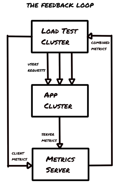

Instead of relying on magic formulas which are hard to explain (and sometimes defend) or on endless and error-prone manual testing, we thought of picking an idea out of control theory that could give us both automation and precision at the same time: a feedback loop.
The idea is quite simple: have the load testing engine react to what’s happening on the target system by dynamically changing the amount of load applied in response to some event. This is achieved through the monitoring of those metrics that can best signal service degradation. Some that we make use of are:
- Request durations (average and percentiles)
- Request errors rate
- Client timeouts rate

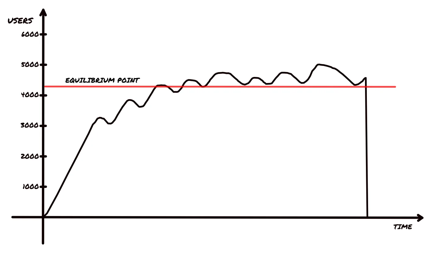

The load testing software constantly increases the number of active users up until it detects signs of performance degradation. This happens when the metrics being monitored reach their configured thresholds (e.g., 100ms for average request duration). In response to such an event, the load testing engine starts to lower the number of users. This process continues for a while until an equilibrium point is reached. This value, over which performance starts to degrade, gives us a fairly good estimate on the user capacity our target application can comfortably support.
