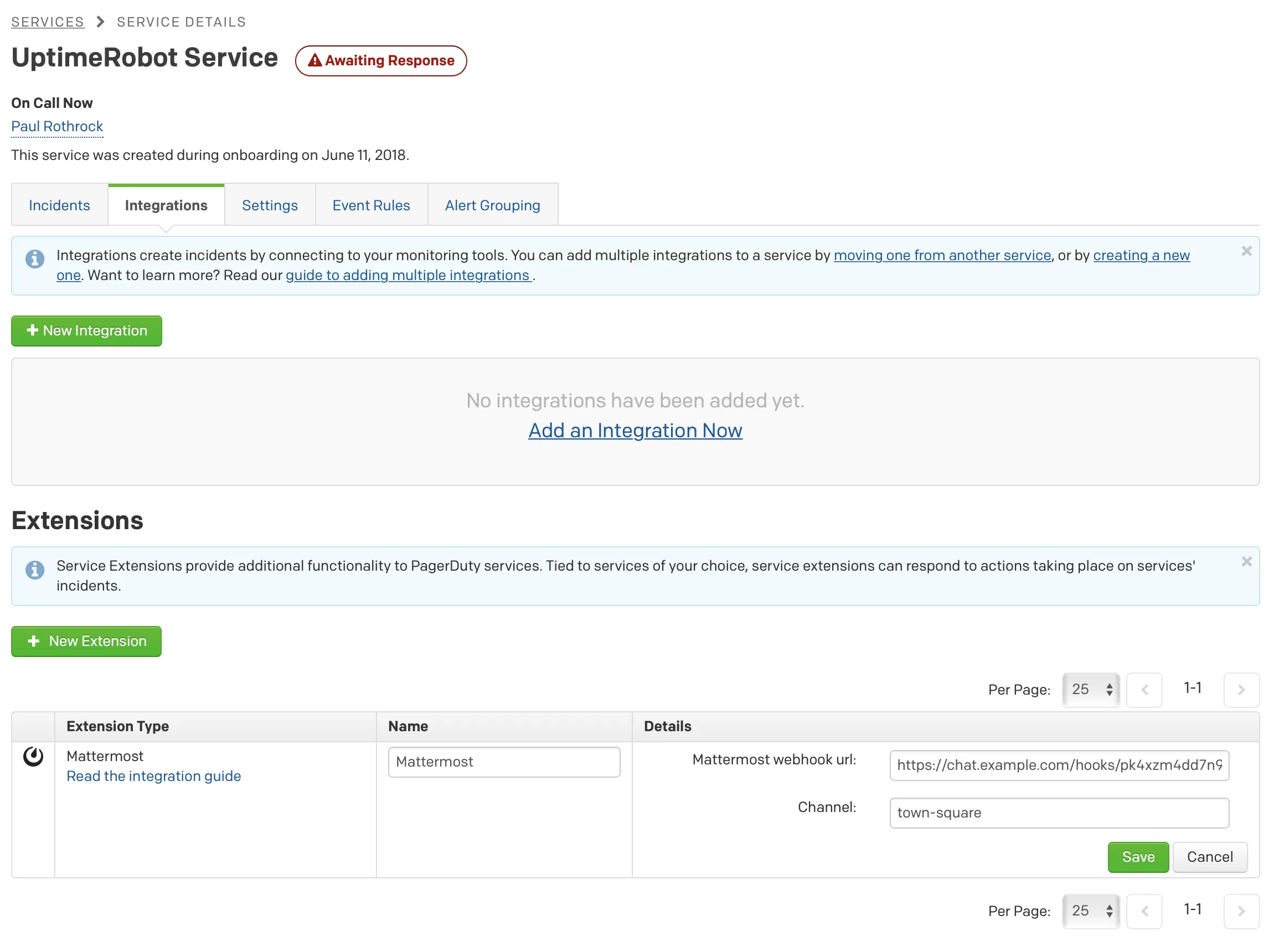

- Create an incoming Mattermost webhook and copy the URL

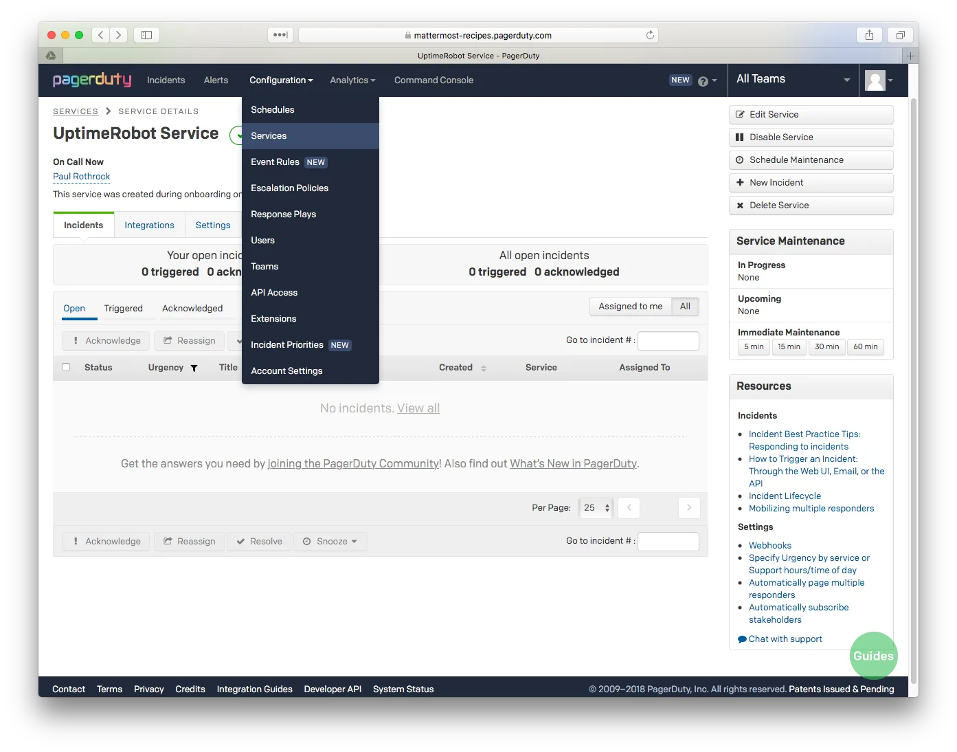

- In PagerDuty, go to
Configuration>Servicesand click on or create a new service
- Under the
Integrationspanel, add anExtensionand search for Mattermost - Enter a name for your Integration, and then paste the Mattermost webhook URL from step 1 into the box. If you want, you can also specify a user or channel to send to or use the one you configured with Mattermost.

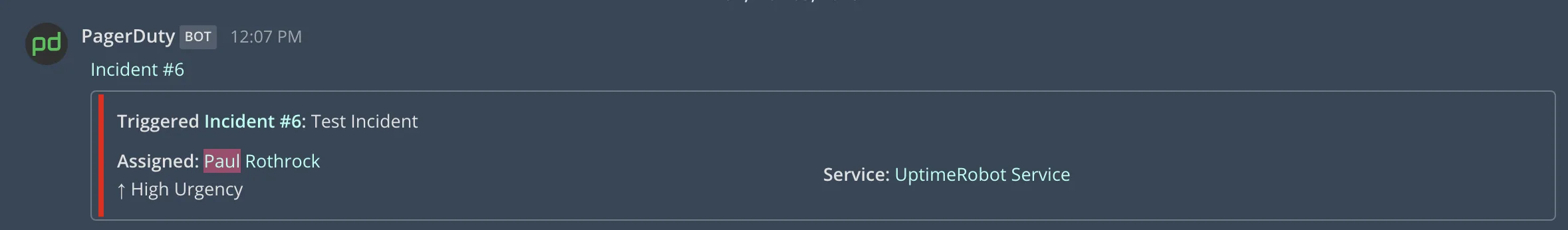

- Create a test incident in PagerDuty. You should see a message similar to this in Mattermost.

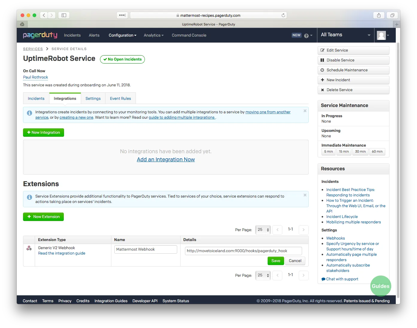

Outgoing webhooks in PagerDuty are linked to monitoring services. But first, you need to add it as an extension to that service. To get to them, go to Configuration>Services.
Then click the service name and click the Integrations tab and click New Extension and enter a name for your webhook and the URL to call, which should end with pagerduty_hook to match the hooks.json file.

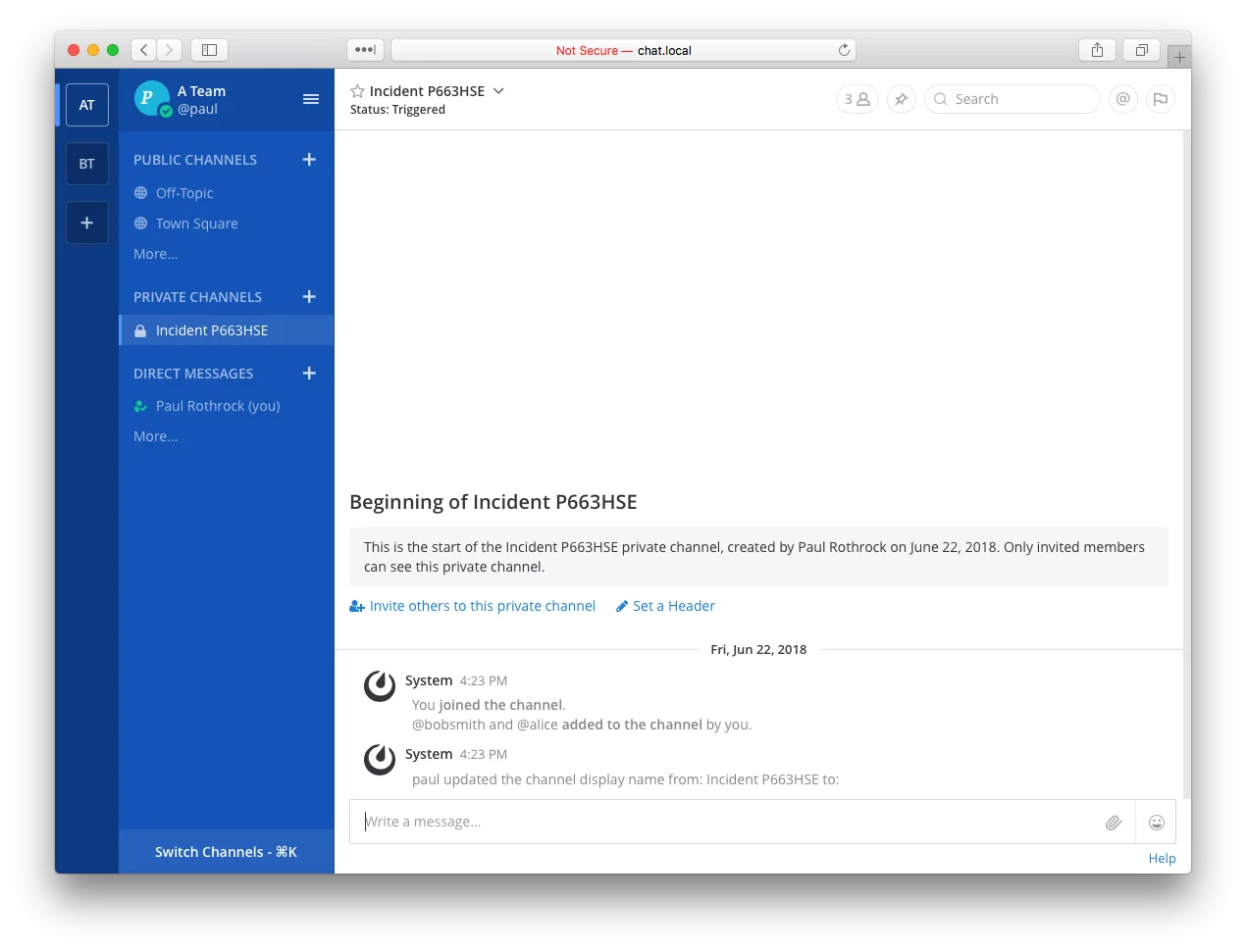

Next, trigger an alert in PagerDuty and acknowledge and resolve it. When the issue is created, you’ll see a private channel created for the incident, with a header that shows the status of the ticket:

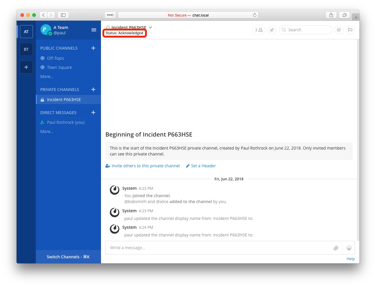

When the ticket status is updated, like with an acknowledgement, it updates the channel header to indicate the new status:

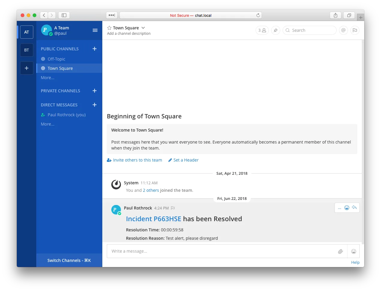

And when the issue is resolved, users are disinvited from the channel and the resolution is posted in Town Hall with some information to let the whole team know the problem is fixed:
