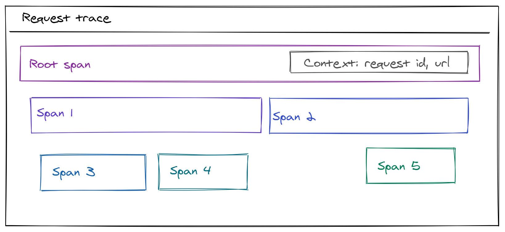

  • Trace: A recording of the execution path of a request
  • Span: A named, timed operation representing a contiguous segment inside the trace
  • Root Span: The first span in a trace – a common ancestor to all spans in a trace
  • Context: Information identifying the request, required to connect spans in a distributed trace
A trace recording usually looks something like this:
Request trace

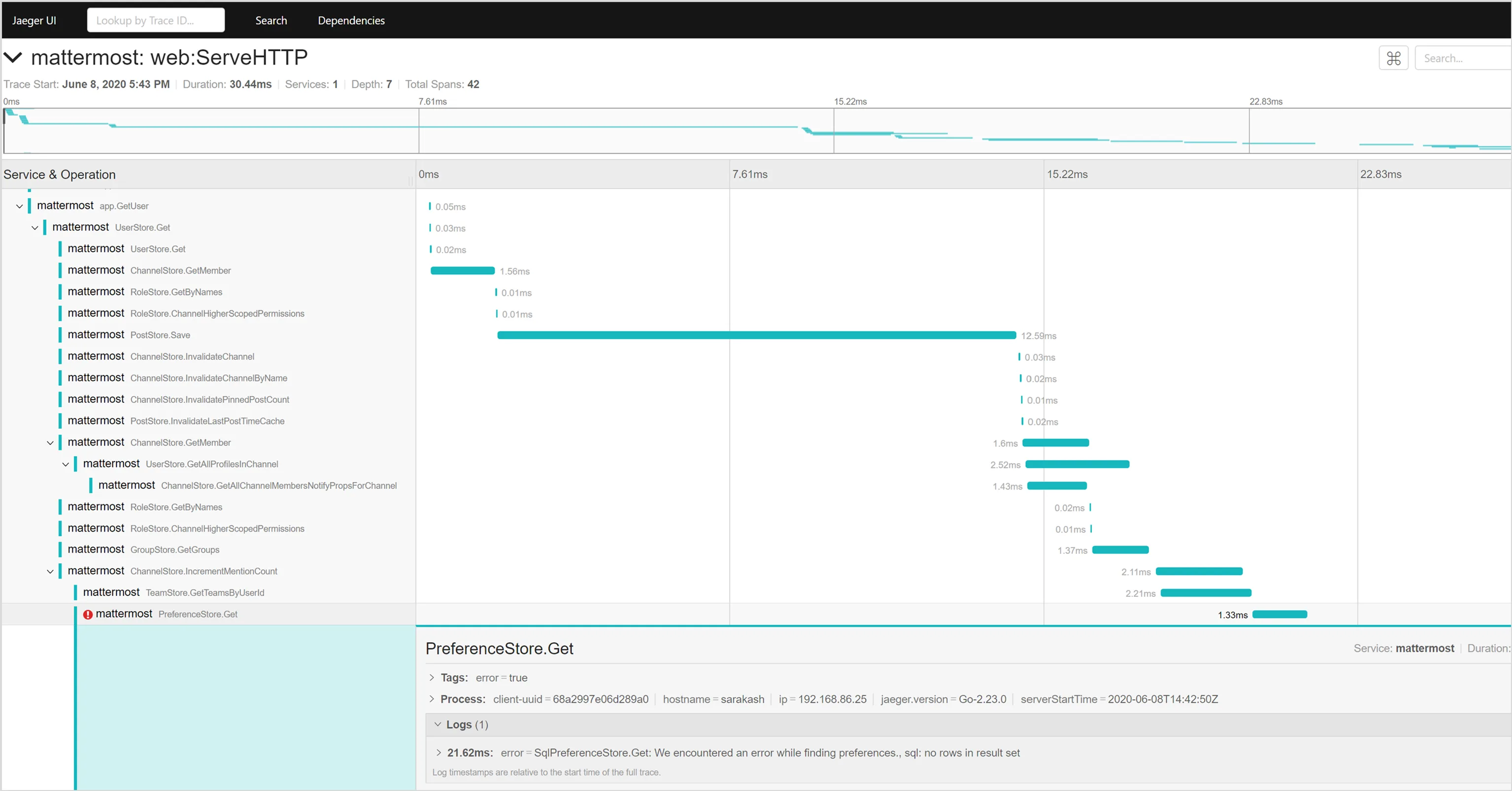

So what are we actually working on? We want to make sure that every API request that’s being handled by our server will get recorded into a trace, together with context information. This gives us the ability to dive deep into the execution and allow easy problem analysis.
The resulting system trace will look like this (using Jaeger web-ui visualization):

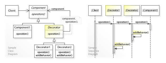

Decorator pattern
Before diving into our solution, I want to first introduce the decorator pattern.
To quote Wikipedia:
In object-oriented programming, the decorator pattern is a design pattern that allows behavior to be added to an individual object, dynamically, without affecting the behavior of other objects from the same class. The decorator pattern is often useful for adhering to the Single Responsibility Principle, as it allows functionality to be divided between classes with unique areas of concern. The decorator pattern is structurally nearly identical to the chain of responsibility pattern, the difference being that in a chain of responsibility, exactly one of the classes handles the request, while for the decorator, all classes handle the request.

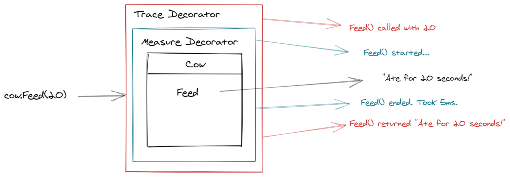

In simpler terms, let’s say we have an object called Cow that has some methods:
We want to introduce additional functionality on top of what Cow already does, without modifying the actual code of the Cow object. For example, we want to measure performance of each method and log the parameters that are being passed to each method. Here’s how it would look if we apply the decorator pattern:
We wrapped each method of Cow in a chain of additional functions: f(x) = y became f(x) = a(b(y)), with each function having its own responsibility.
If we apply the same pattern to our problem, we can decorate all of mattermost-server API calls with OpenTracing, without actually modifying the functions themselves!

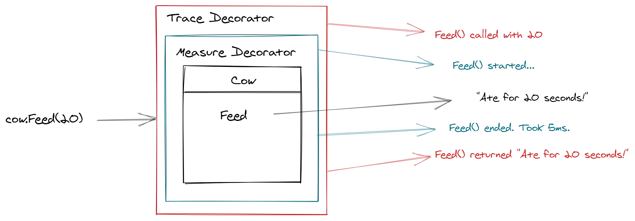

We can wrap it in a proxy:
const tracerHandler = {
  get: function(target, prop, receiver) {
    if (typeof target[prop] === "function") {
      return function(...args) {
        console.log(`'${prop} 'called with arguments: `, ...arguments);
        return target[prop](...arguments);
const timerHandler = {
        console.log(`starting '${prop}'`);
        const t1 = window.performance.now();
        const res = target[prop](...arguments);
        const t2 = window.performance.now();
        console.log(`'${prop}' took ${t2 - t1}ns`);
        return res;
const proxy = new Proxy(cow, tracerHandler);
const proxy2 = new Proxy(proxy, timerHandler);
console.log(proxy2.feed(20));
console.log(proxy2.speak(3));
