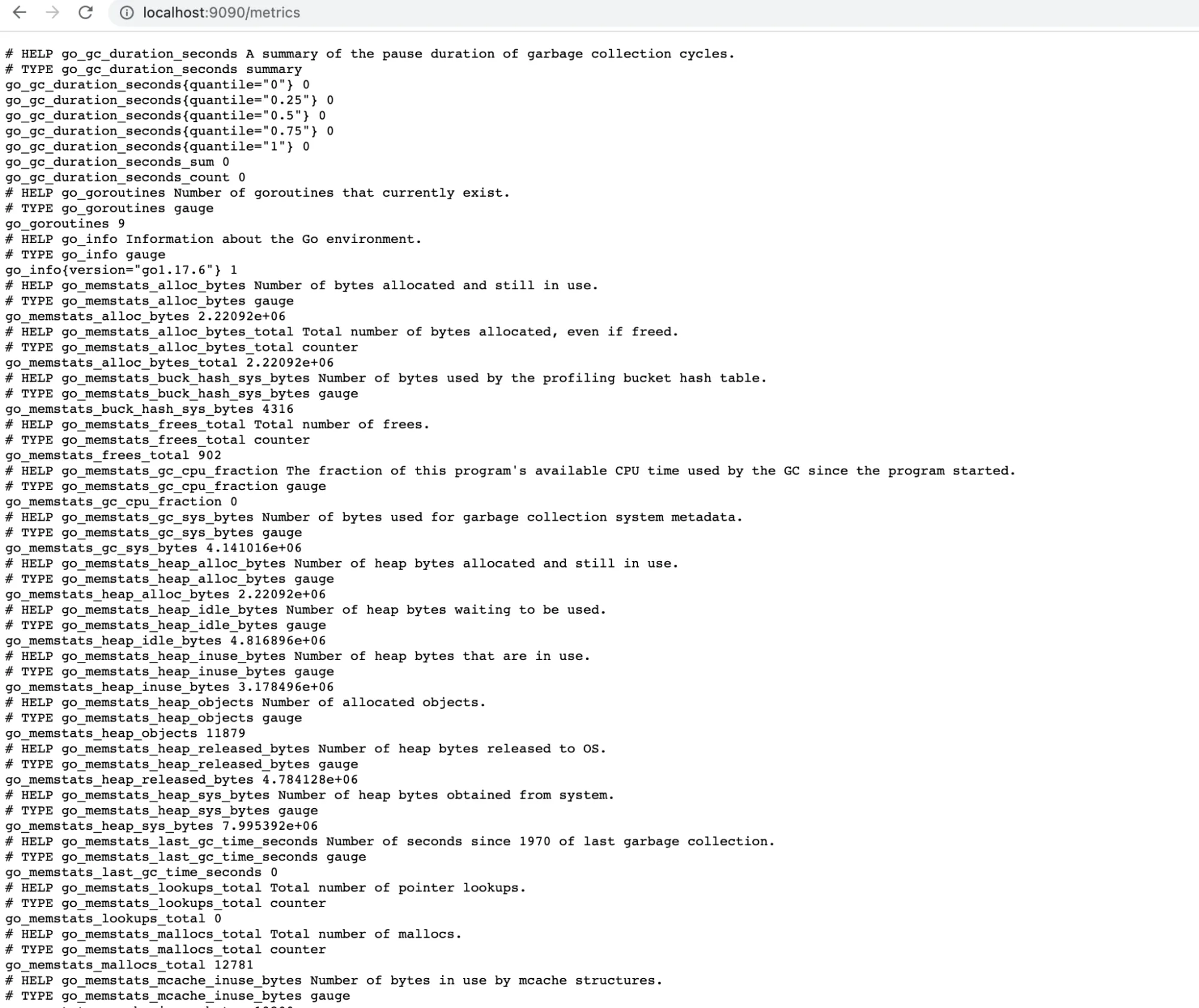

The metric output when you visit localhost:9090/metrics looks like this:
concurrency in golang: Metrics output
Prometheus also monitors a lot of additional information. This also gives us insights into our application’s resource consumption. As you can see, there are nine goroutines. This is because of the concurrent execution of the Golang compiler needed to run the main code. This will increase when you add goroutines from your side.

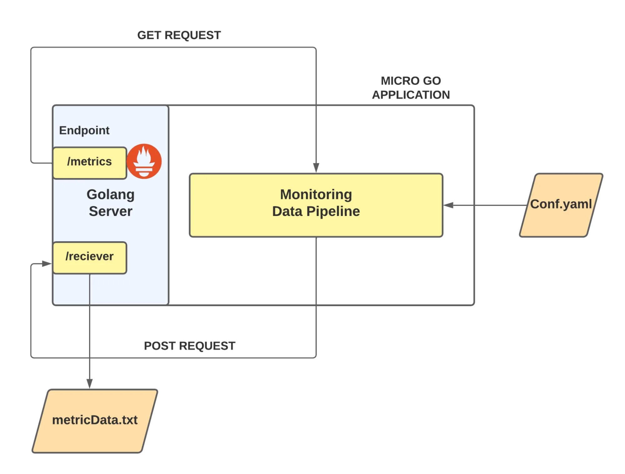

After understanding the basics of Prometheus metrics, it’s time to start building the data pipeline. Please refer to the above diagram to understand what you’re going to build: a concurrency-driven data pipeline that will have four steps.
The first step is data aggregation, where each microservice we’re monitoring will have a dedicated goroutine that queries/metrics the endpoint of our application to get Prometheus endpoints every five seconds. After fetching the metrics, based on the microservice name, each goroutine picks up the metrics as defined in config.yaml. Just these metrics are picked and sent to an input-only channel, which is the aggregator channel. The value sent to the aggregator channel is a string that has the metric name and value separated by a space:

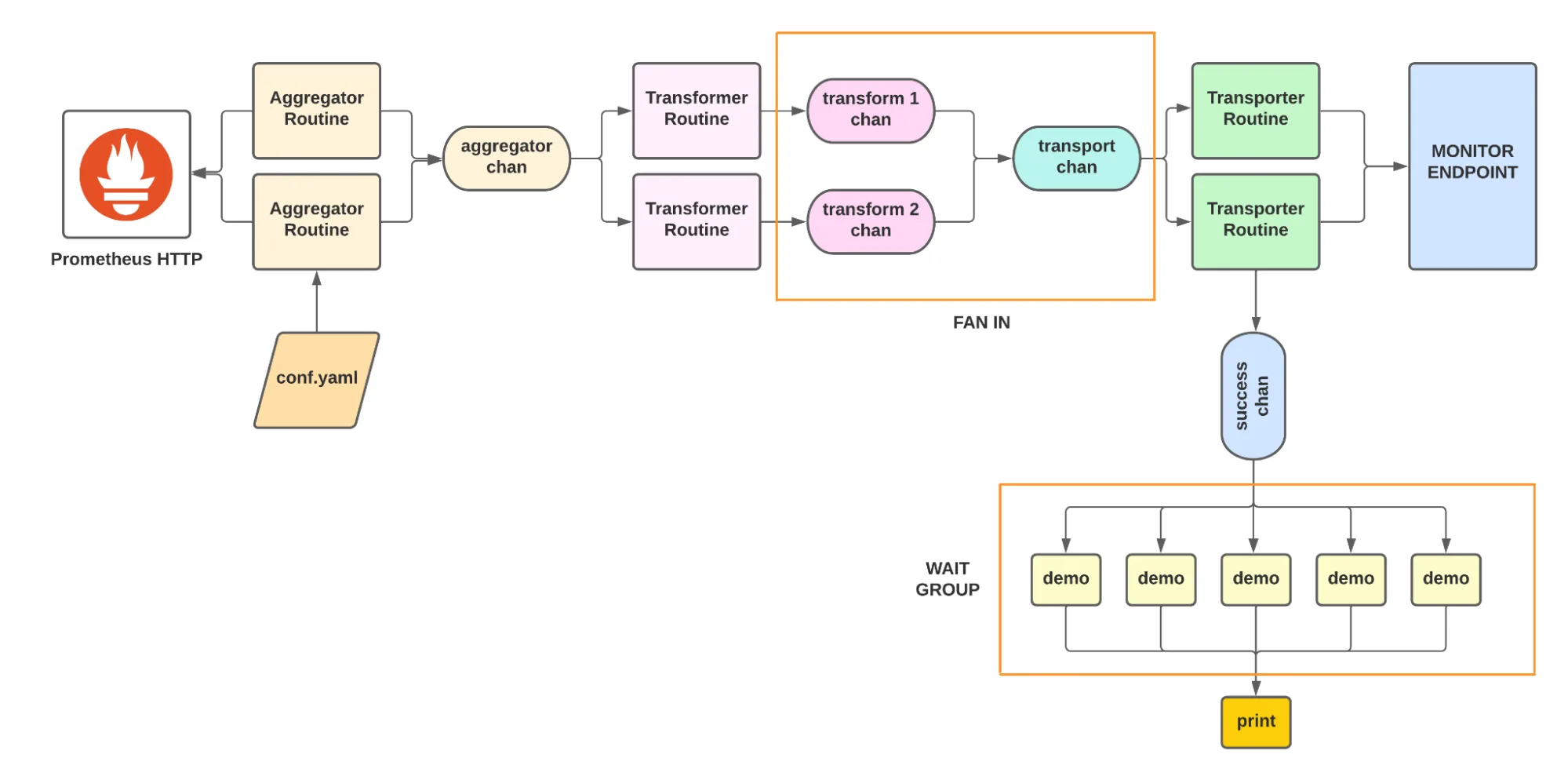

Combining Transformed Data with a Fan-In Mechanism
You have two goroutines that are sending their outputs to two different channels. The process of fan-in takes the values in these two channels separately and inputs them to a single channel. In this case, the order doesn’t matter. It’s even possible to impose timeouts if the previous processes are bulky and time-consuming.
A select statement in Golang is most useful for this case. This is important, since we’d need an infinite loop as the channels are unbuffered and never closed.

In this example, we are imposing a timeout of three seconds if transform1Chan and tranform2Chan are empty. This is a useful mechanism when the application has irregular data streams.
As you can see, the data from transform1Chan and transform2Chan are both input to a transportChan. This is again done with the help of a goroutine, which runs forever. We don’t want to miss any data. All the channels set are unbuffered, i.e., they don’t have any limits on storage of data. As such, they are blocking in nature and wait until there are further events to process.

Now, let’s bind all the functions together. As you can see in the code below, we first read the config.yaml file to fetch the metrics that need to be monitored. Next, we set up a channel called aggregateChan of type []string. This is then passed to two goroutines which monitor signin and signup microservices respectively. The config data is parsed and accounted for to get the data in aggregateChan.
The two goroutines you just created will run indefinitely and call the Prometheus HTTP every five seconds to get data for each microservice. So, the value in aggregateChan will keep on getting populated every five seconds.
Next, we create two channels of type string. These are the channels that transformer goroutines will write to. Both the transformer goroutines we spin up next read from the aggregator channel. For each record read, that record is deleted from the aggregator channel. This ensures that there is no duplication of metrics.
Each goroutine will transform the data and write to transform1Chan and transform2Chan. The order of data in the pipeline does not matter and any goroutine can pick up any available record in aggregateChan based on the execution environment. These two channels will also get populated and so, to prevent data race, we need to set up a fan-in mechanism.
The data from tranform1Chan and transform2Chan is written to a transport channel. The transportChan is read by two goroutinesm which then send the data to our configured endpoint. The response from the final endpoint is collected in a channel called successChan.

	go dataTransformer(log, aggregateChan, transform2Chan, 2, metricEndpoints.Metadataregion, metricEndpoints.Metadatapipelineid)
	transportChan := make(chan string)
	// now we need fanin of 2 channels to a single channel. This final channel will be passed for transportation
	// we can write another goroutine for this
	go func() {
		for {
			select {
			case op1 := <-transform1Chan:
				transportChan <- op1
			case op2 := <-transform2Chan:
				transportChan <- op2
			case <-time.After(3 * time.Second):
	// this has the output from our server
	successChan := make(chan string)
	// spin 2 goroutines in parallel to get the successChan fast
	go dataTransportation(log, transportChan, successChan)
	// now we implement a WaitGroup to get the first 5 values only of the response body
	var wg sync.WaitGroup
	for i := 0; i < 5; i++ {
		// add to the waitgroup. Acts like a semaphore
		wg.Add(1)
		go showDemo(log, &wg, successChan)
	// this goroutine only runs after the first 5 responses have been printed
	go func() {
		wg.Wait()
		log.Info("=========== WE ARE DONE FOR THE DEMO ===========")
	return nil
As you can see, the data flow in our data pipeline is asynchronous and indefinite. As long as the Prometheus endpoint is up, our pipeline will keep on submitting data.
The goroutines have unbuffered channels and they don’t depend on the previous goroutine. However, this will not always be the case. You may want to run certain goroutines after the execution of a goroutine is done. This is done using WaitGroups in Golang provided by the sync package. When you define a WaitGroup, you can add the goroutine to WaitGroup using wg.Add(1) and remove the execution from WaitGroup after goroutine has completed using wg.Done(). Goroutines with wg.Wait() will wait for all the goroutines added in wait group to call wg.Done(). This is a numerical counter and can be seen as a semaphore-based execution. In the above code, we call five goroutines that simply perform a print from the success channel. After printing, they update the waiting group. Another goroutine waits for these groups and then prints the message “WE ARE DONE FOR THE DEMO” finally.
Receiving Data from Applications
You can set up an internal endpoint that will be queried by your monitor module. This will simply output the received records to a file. The use case in this scenario is to dynamically filter and get the specified metrics only to a text file that can be viewed by upper management.
func simplePostHandler(rw http.ResponseWriter, r *http.Request) {
	fileName, err := os.OpenFile("./metricDetails.txt", os.O_APPEND|os.O_CREATE|os.O_WRONLY, 0644)
	if err != nil {
		log.Fatal("error in file ops", zap.Error(err))
	defer fileName.Close()
	reqBody, err := ioutil.ReadAll(r.Body)
	if err != nil {
		log.Fatal(err)
	fileName.Write([]byte(reqBody))
	fileName.Write([]byte("\n"))
	rw.Write([]byte("Post Request Received for the Success"))
