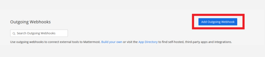

1. Go to the Menu and choose Integrations
2. At the following screen, choose Outgoing Webhooks
3. After that, you’ll be able to see your existing outgoing webhooks and have the option to add a new one.
4. Next, set up the outgoing webhook.

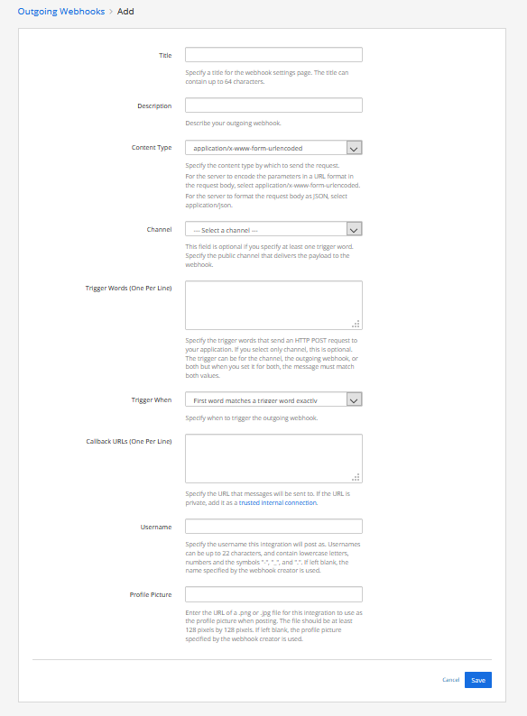

Follow these steps:
  1. Give the outgoing webhook a title.
  2. Give the outgoing webhook a description.
  3. Specify the Content Type of the request you will receive (e.g., www-form-urlencode or JSON).
  4. Select a channel or specify the trigger words to send an HTTP POST request to the webhook. (Trigger words only work in public channels. For using your outgoing webhook in a private messages you need to use a slash command.)
  5. Select the default channel that receives the answers that the outgoing webhook will send.
  6. Choose if you want to lock the incoming webhook to the channel or that it is allowed to send to other channels as well.
  7. Choose if the trigger word has to be an exact match.
  8. Give the URLs where the POST-request will be sent to. Jump to this if you are planning to send to internal IP-addresses! We will be using HTTPS and if you have a self-signed certificate, you need to enable unsecure connections. Here is how you do that.
  9. Give the username that will be displayed.
  10. Give the URL for the profile picture that will be displayed.
  11. Click the save button.

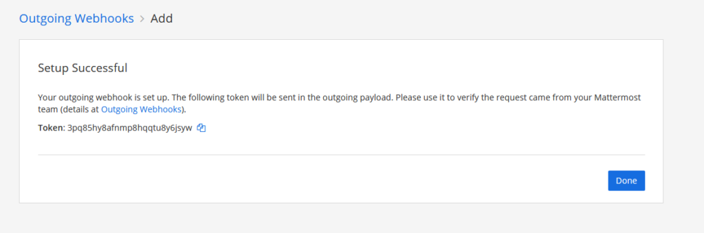

At this point, you’ll receive confirmation that the webhook is created. You’ll also get a very important token that we will need in our next step.

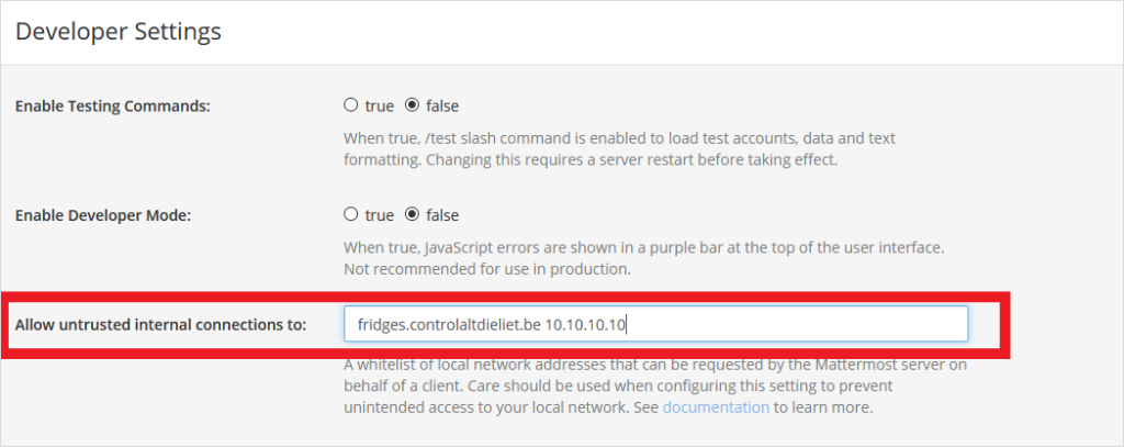

Allow untrusted internal connections
If you want to send your requests to your internal network, you have to specify to which hosts you want to send. Mattermost can only send to the specified internal hosts or hostnames! Adjust this setting by navigating as follows: System Console -> Environment -> Developer.

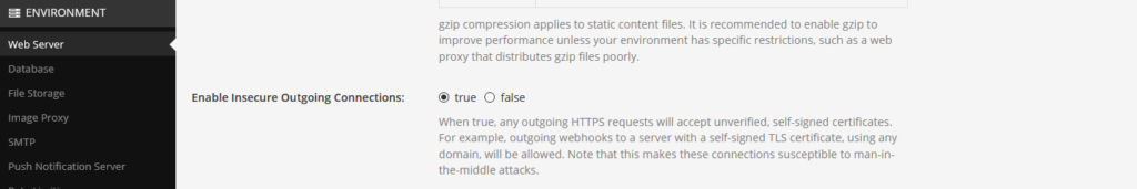

Unsecure outgoing connections
If you are using self-signed certificates like in our example, you need to allow outgoing HTTPS connections with self-signed unverified certificates. You’ll find this setting here: System Console -> Enviroment -> Web Server.
