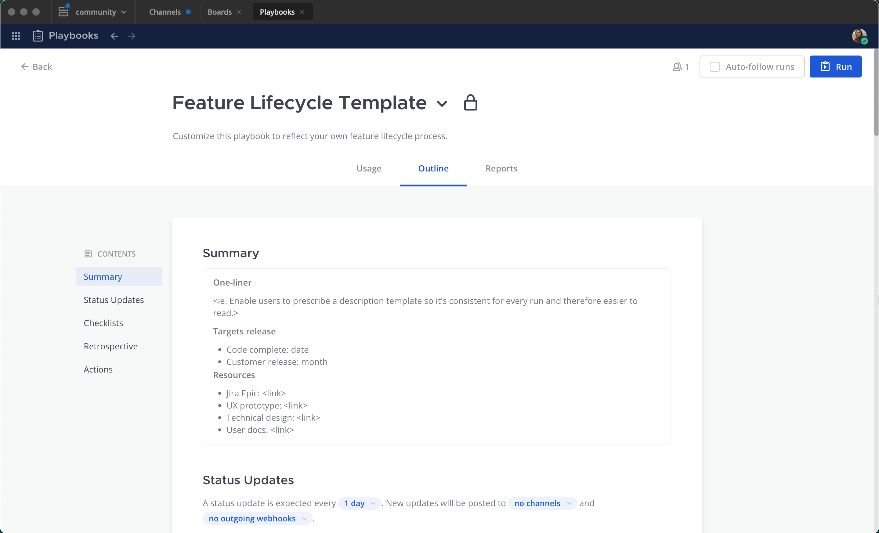

- In Mattermost, navigate to Playbooks using the global menu in the upper left corner. Select the Playbooks button next to Runs. Scroll down if needed to bring a section titled “Do more with Playbooks” into view. Select the “Feature Lifecycle” template.
- OR, to download and install any PB template from github.com/mattermost/mattermost-product-templates (or a friend) you may copy, export and import playbooks as .json files.
- Once you are looking at the template in Mattermost, you’ll be able to start modifying it to match your own process. Start with the title! Here are some other areas you might consider making changes:
- Update the playbook description so teams know when to use the playbook and who should use the playbook.
- Update the run summary template to include placeholders for reference links that make sense for your team. This can include a template statement describing the feature (ie “as a __ I want __ so that __” or similar), target dates for release to various environments, links to analytics, GitHub/GitLab repositories, designs and more.
- Set a cadence, destinations, and template for regular status updates. You may want to send updates to other channels in Mattermost, or to outgoing webhooks. These can be changed during a run, in case the situation evolves.
- Update the checklists. Add sections, rename things, add checklist items, and for a real power move, add slash commands. Everything accepts markdown so feel free to include detail and links.
- Define your key metrics in the retrospective section – How will you measure the success of your process? Our team measures “Code Complete Estimation Accuracy” as an integer type metric. The other options are dollars and duration.
- Set up a retrospective template. This is a text field your team will fill in at the end of a run, following a template so that it’s easy to browse and skim retros in bulk later on. Specific cues like “How many big changes did we introduce after initial planning and why” can help identify areas for improvement on future runs.
- Set channel actions to automatically invite the same people or teams for every run of your playbook, send an outgoing webhook when a run starts, and keep your sidebar tidy by categorizing the run channel.
