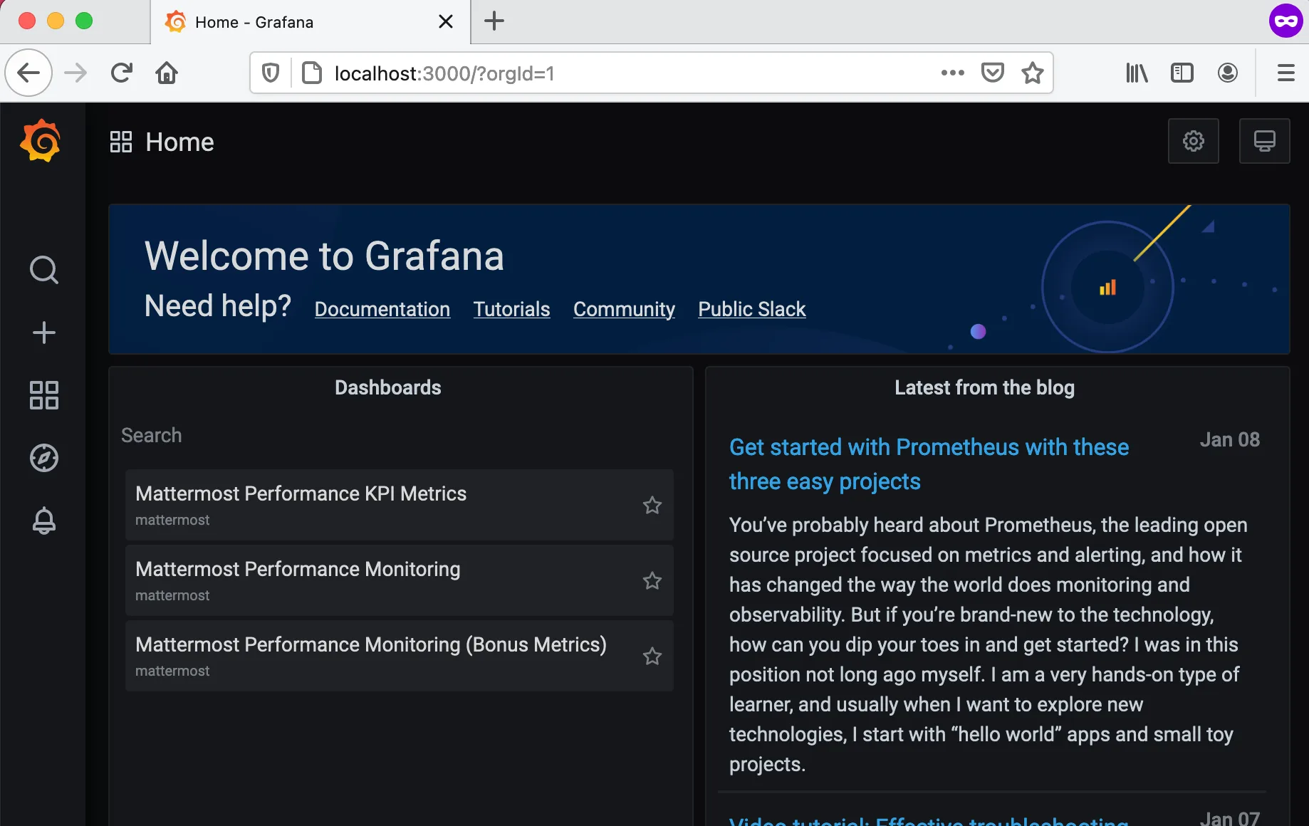

This means that simply running make run-server gets you immediate access to the Mattermost Performance dashboards at https://localhost:3000:

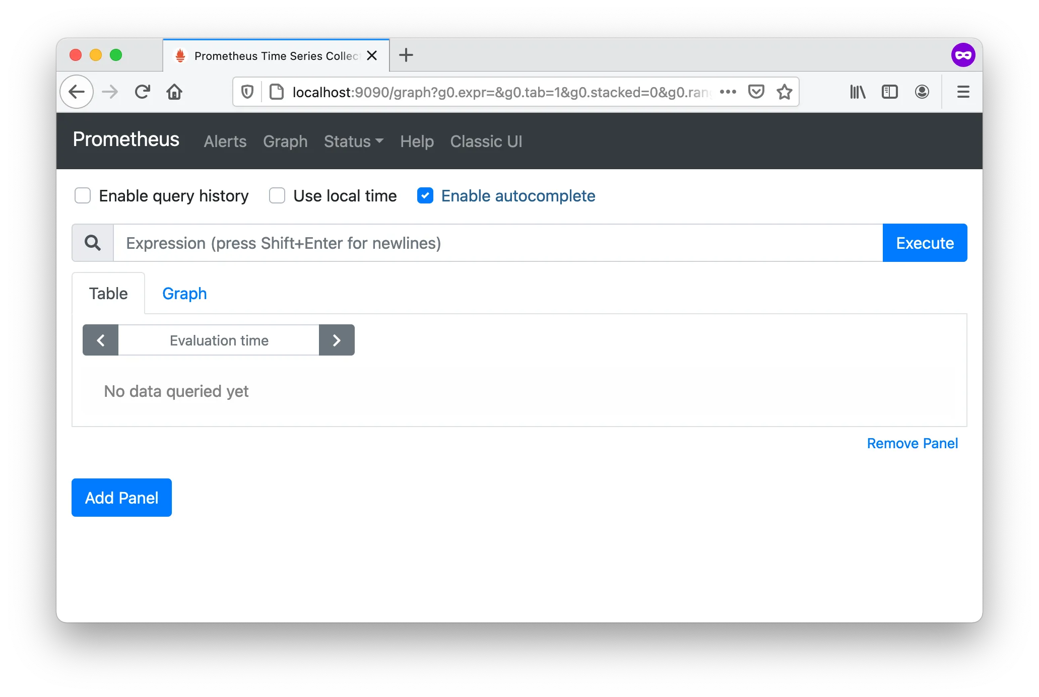

Prometheus is also available at https://localhost:9090:

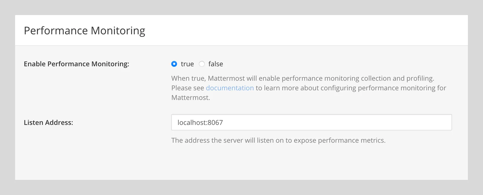

Second, enable performance monitoring. You can do this manually via config.json and setting MetricsSettings.Enable to true, or by exporting MM_METRICSSETTINGS_ENABLE=true into your shell before starting the server, or by enabling this manually via the System Console at /admin_console/environment/performance_monitoring:
