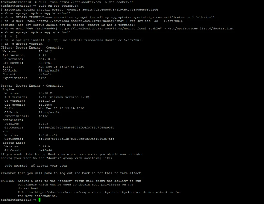

Now, it’s time to install Docker:
curl -fsSL https://get.docker.com -o get-docker.sh
sudo sh get-docker.sh
sudo usermod -aG docker $(whoami)

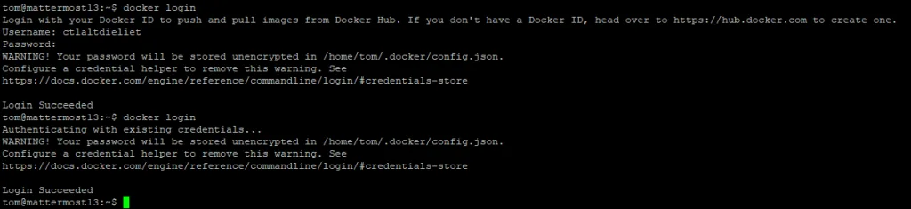

docker login

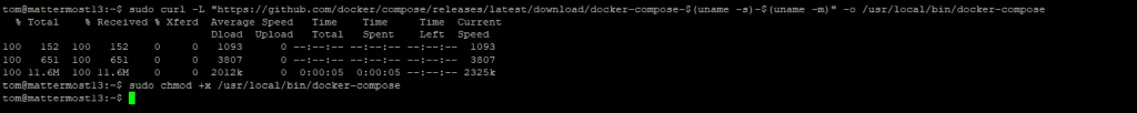

Install docker-compose
sudo curl -L "https://github.com/docker/compose/releases/latest/download/docker-compose-$(uname -s)-$(uname -m)" -o /usr/local/bin/docker-compose
sudo chmod +x /usr/local/bin/docker-compose

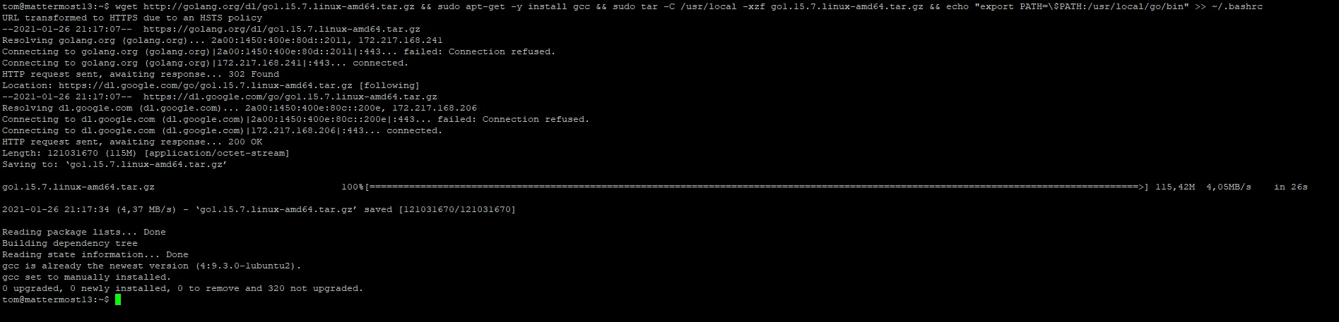

Install Go
Mattermost is written in Golang and React. To build Mattermost plugins, you need to install Go:
sudo rm -rf /usr/local/go
wget https://golang.org/dl/go1.15.6.linux-386.tar.gz
sudo tar -C /usr/local -xzf go1.15.6.linux-386.tar.gz
sudo apt-get remove -y gccgo-go && wget https://golang.org/dl/go1.15.6.linux-amd64.tar.gz
sudo tar -C /usr/local -xzf go1.15.6.linux-amd64.tar.gz
echo "export PATH=\$PATH:/usr/local/go/bin" >> ~/.bashrc

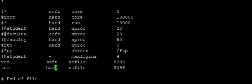

Modify /etc/security/limits.conf
After that, you need to modify /etc/security/limits.conf. Use Sudo, since you need to do this as an administrator. To do this, add the following two lines, replacing YOURUSERNAME with your username:
YOURUSERNAME soft nofile 8096
YOURUSERNAME hard nofile 8096

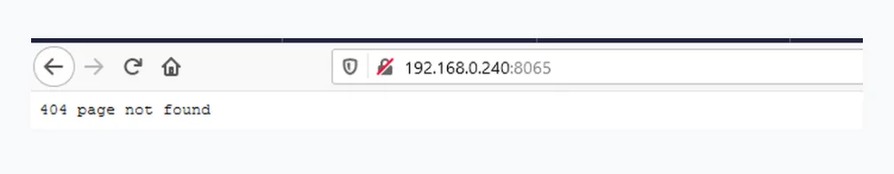

To do this, fork the mattermost-server to your own GitHub account. Then create a folder called mmplugins and clone the mattermost-server into that folder. Once that’s done, you need to build the server. When the process is complete, you’ll see its listing on port 8065.

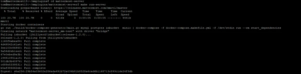

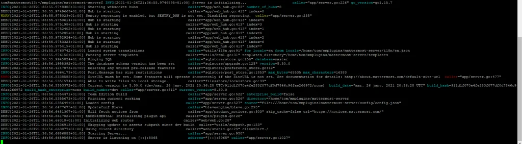

make run-server

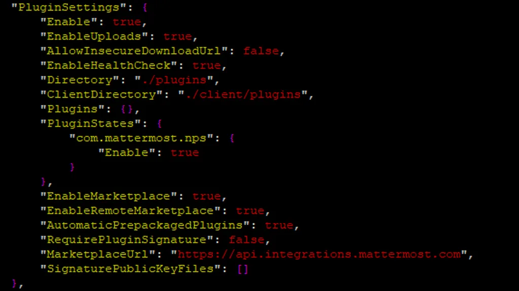

Modify the configuration file
Next, go to the mattermost-server/config/ folder and modify the config.json file.
You’ll need to enable plugins. So, look for PluginSettings and make sure they are enabled.

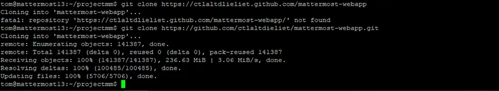

Go back to the mmplugins folder we created earlier and clone the mattermost-webapp into that folder:
git clone https://github.com/YOUR_GITHUB_USERNAME/mattermost-webapp.git

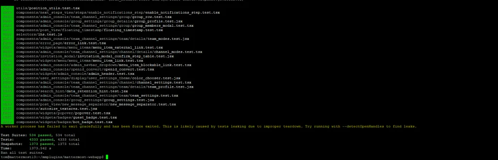

make test

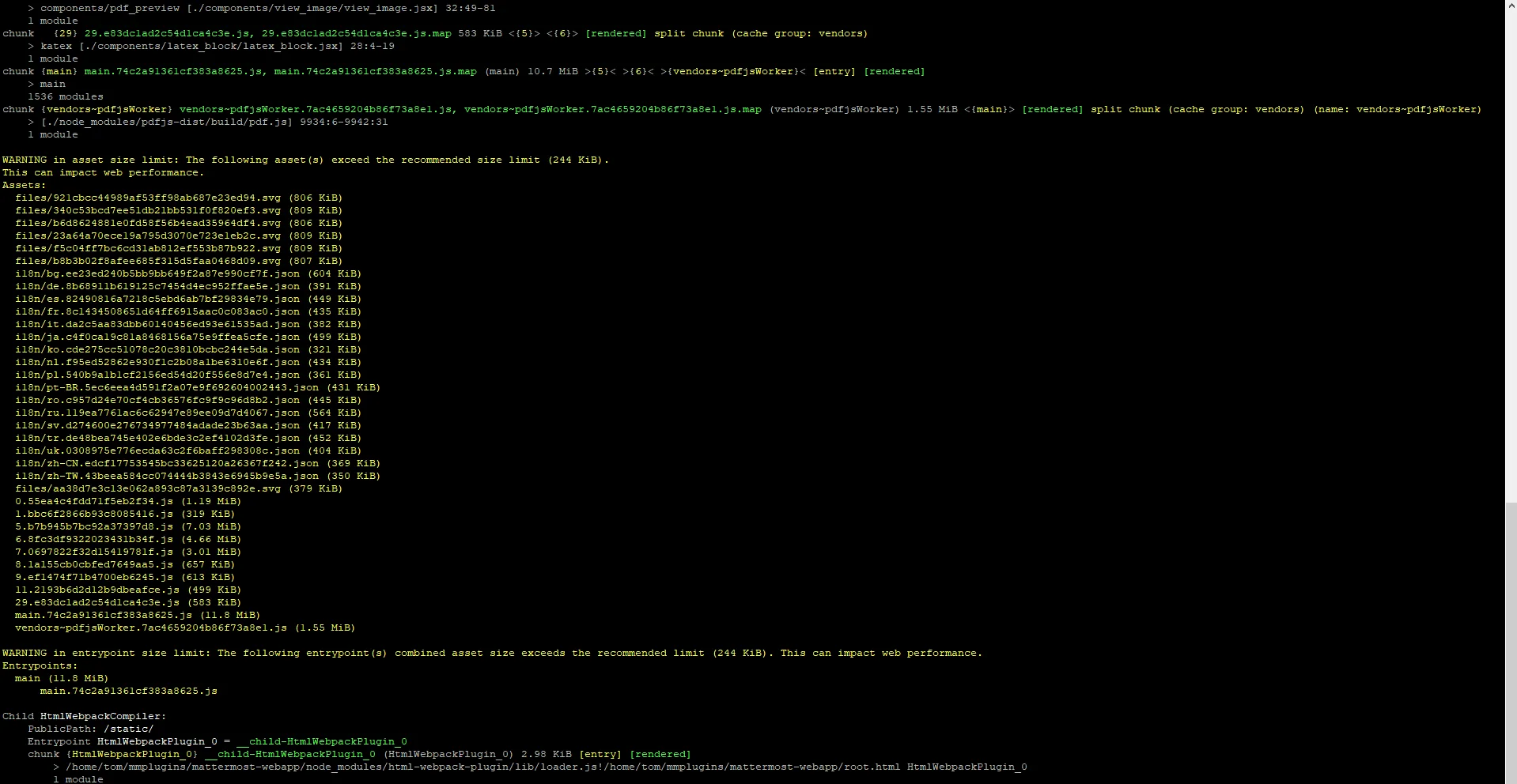

make run

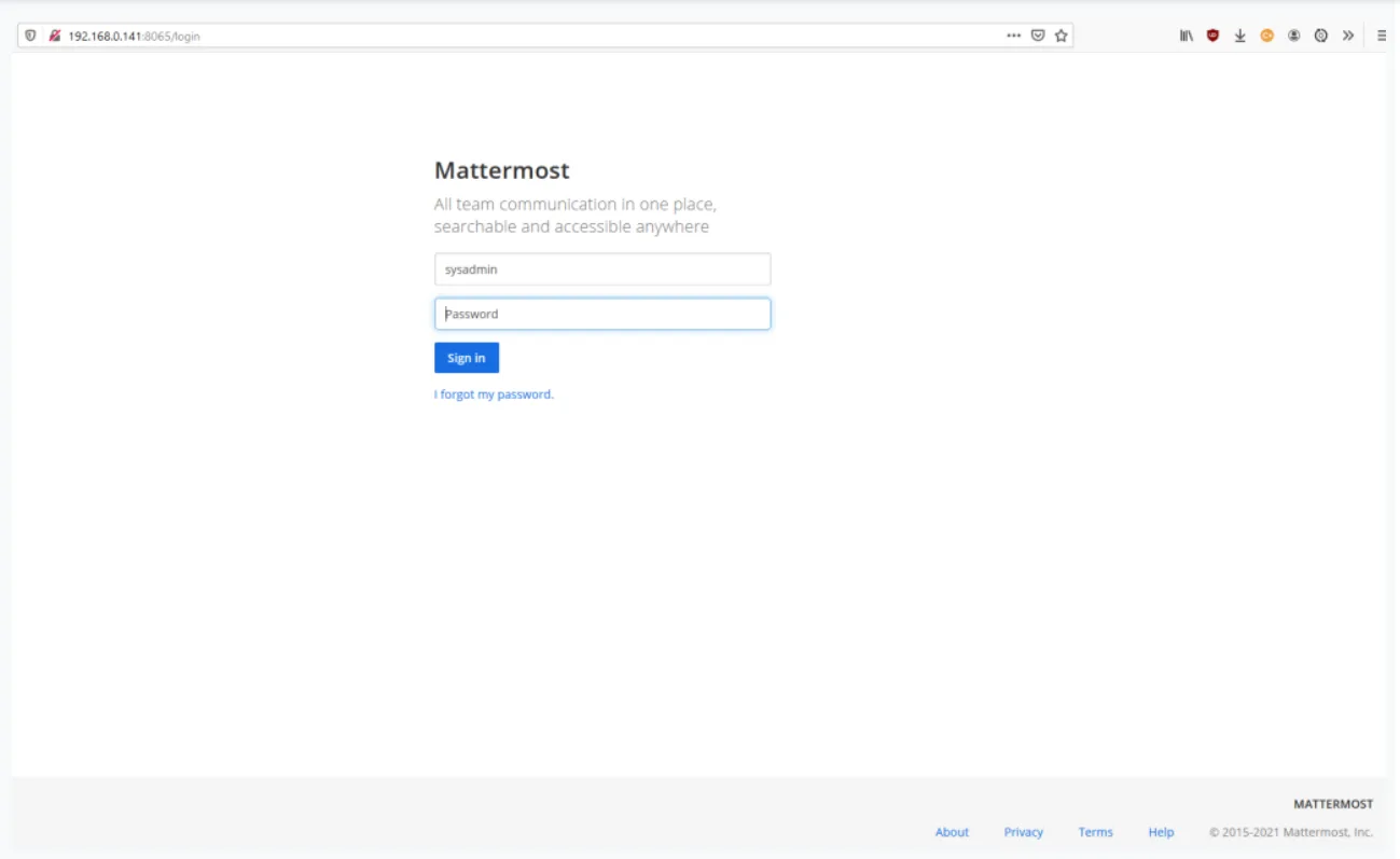

Browse to your Mattermost server
At this point, you can open your browser and surf to your Mattemrost server. You’ll be greeted by the webapp and can log in!

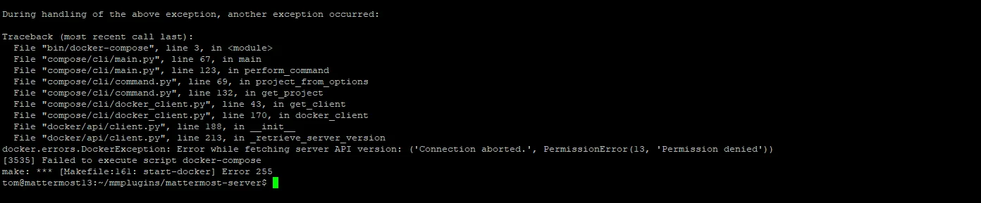

Did you run into a ‘Permission Denied’ error?
When you’re starting your server and get a “Permission Denied” error, you don’t have the ability to start Docker with your account. An ugly way to solve this is by making the Docker-socket world read-writeable:
sudo chmod 666 /var/run/docker.sock
