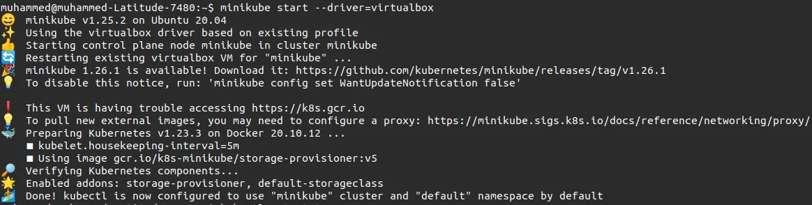

Set up minikube
minikube is a tool that is used to create a node locally where you can quickly set up a cluster. To use minikube, you need a driver. In this tutorial, you’ll use VirtualBox or Docker.
You can create a cluster with minikube using VirtualBox by running the following command:
minikube start --driver=virtualbox
set up minikube
If you want to use Docker, run the following command:
minikube start --driver=docker

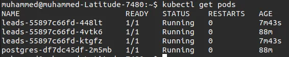

After a few minutes, you can run kubectl get pods, and you’ll see Postgres is running successfully:
postgres running
If yours isn’t running, run the command below and see what’s going on so that you can debug from there:
kubectl describe pod pod-name

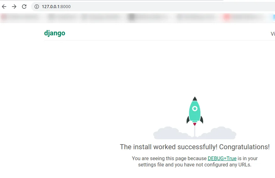

You can now test the application using the services. However, the services are internal to minikube, and you won’t be able to access them through the browser. You can counter this by using the port-**forward** command to direct the internal port to an external port that can be accessed locally. To do that, run the command below:
kubectl port-forward svc/leads 8000:80
You should see something like the image below. Running the command above will provide you with a host and port that can be accessed externally.
kubectl port forward
When you open 127.0.0.1:8000 on your browser, you’ll see that your application is running.
django application running successfully

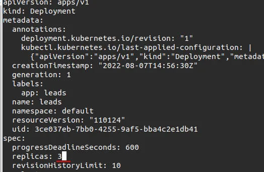

Scale your Django application
When you start having a lot of visitors to your site, you may need to scale your application to make two or more pods serve it. In Kubernetes, you can scale up by editing the number of replicas in the applied deployment to the number of pods you want to handle your application.
You can do this by running the command below, editing the replicas value, and saving it by pressing CTRL+x.
KUBE_EDITOR=nano kubectl edit deployment leads
scale django application
Run the following command, and you’ll see that you now have three pods running your Django application. This means that when one pod is getting a lot of hits, Kubernetes will outsource the workload to other pods.
