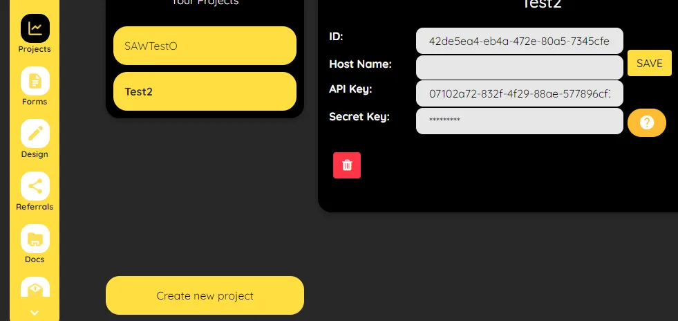

In this section, we will look at how trusted device technology works with an application with the help of SAWO SDK. To do that, we will integrate the SAWO SDK with a simple HTML page. For that, we have to set the SAWO dashboard and get the API Key from there (Note it down in a notepad because we will use it later). Remember, the API key is one of the prime elements that will enable the technology.
SAWO SDK API key

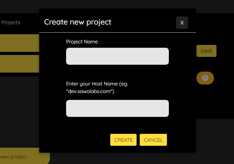

Then, you have to enter the project name and the hostname. For development, enter “localhost” as the hostname and for production, enter the URL of your application as your hostname.
create a new project

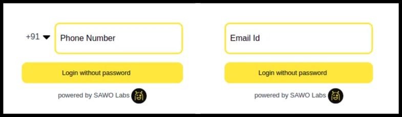

After the successful setup of the SDK, you will see the SAWO login dialogue box on the application home page.
You can log in with a mobile number as well as an email ID.

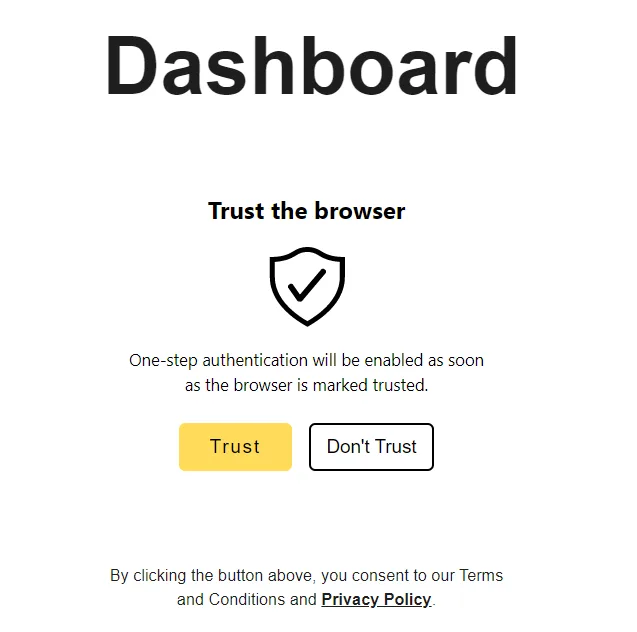

After putting in either of the two, you have to enter the OTP that you will receive. Now, the trusted device technology will come into play, telling you to trust the browser. Click yes, and currently, your browser is authenticated with trusted device authentication. So, next time you log in, you can do that with one click of a button in a passwordless manner.
