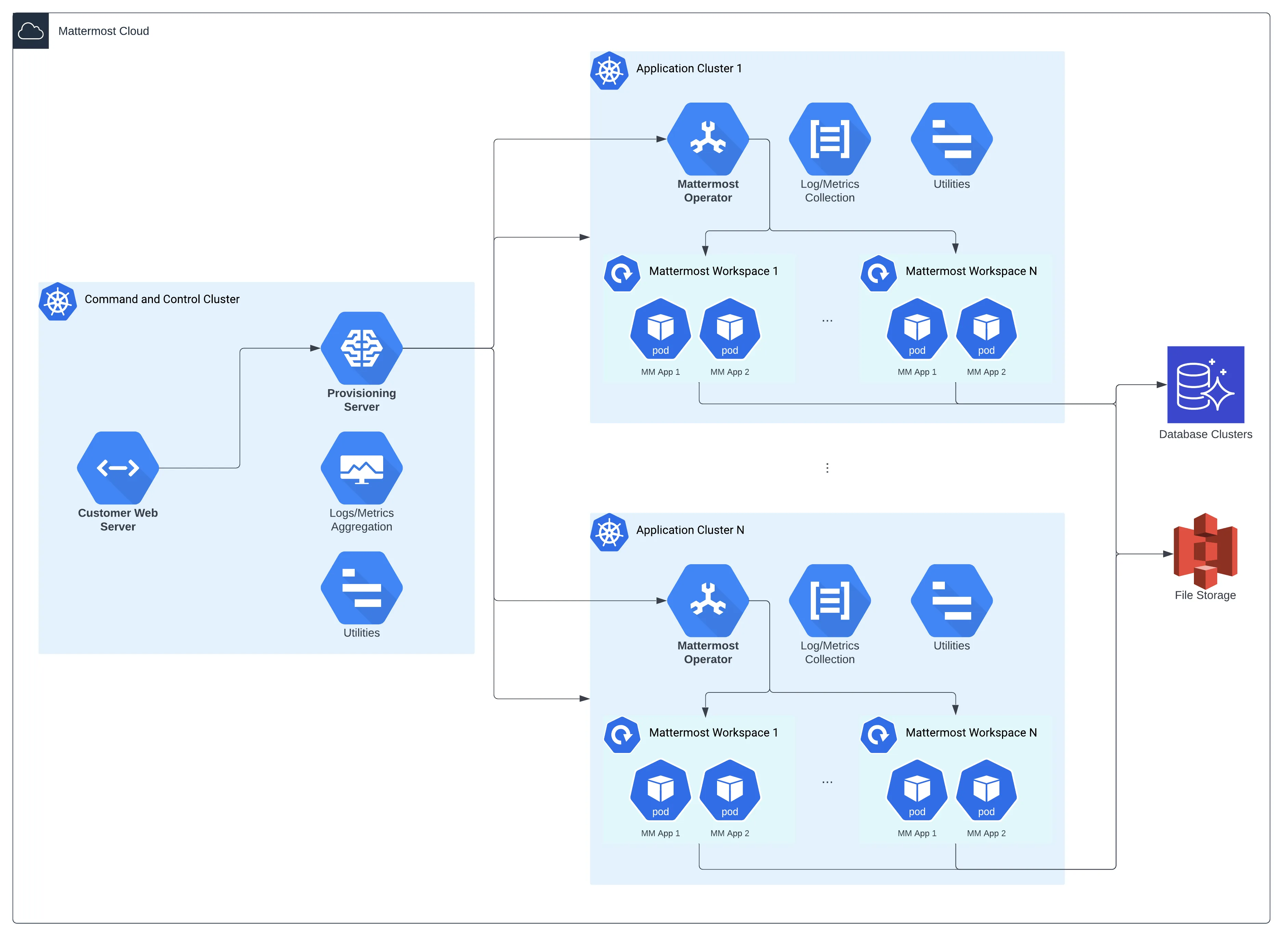

So, we did it. And it looks like this:
The short version of what we did was leverage the orchestration power of Kubernetes and add another layer of orchestration on top of that, which was much more Mattermost-aware, to be able to deploy individual instances of Mattermost quickly and on-demand when a customer signs up for a workspace. This means that each customer who has their own workspace gets their own deployment of single-tenant Mattermost and a set of pods that is only for them.

Getting into some more detail, at a high level there are three primary components of the system:
- Customer Web Server (CWS), or Customer Portal as some of you may be familiar with it
- Provisioning Server – GitHub repository
- Mattermost Kubernetes Operator – GitHub repository
The Customer Web Server is a fairly standard web server. It provides the front-end portal that our customers use to sign up, handles billing and customer account information, and is what tells the Provisioning Server to create or delete new deployments of Mattermosts, what we call installations on the backend. This is what serves pages like this.
The Provisioning Server is the brain, or command-and-control, of our entire Cloud architecture. It is responsible for creating and managing Kubernetes clusters, deploying, configuring, and managing Mattermost installations onto an appropriate cluster, and scheduling and rolling through updates to both clusters and installations.
This is the primary part of that additional Mattermost-aware orchestration layer I mentioned. It has a REST API and is built using a micro-monolith architecture that lets us ship as a single binary that can run one or more supervisors to handle cluster, installation, and other responsibilities separately. If you’d like to learn more about the specifics, check out the original technical specification.
Finally, there is our Kubernetes Operator that handles all the low-level Kubernetes management of the Mattermost installations. It creates all the Kubernetes resources in the cluster needed for Mattermost to run, knows how to perform rolling updates, and other maintenance tasks. If you’re not familiar with Kubernetes operators you can think of it as a system administrator that is an expert on the application being codified into an application that manages the deployment to Kubernetes for you. While we heavily rely on our operator for our Cloud, it is also usable by customers who want to self-host Mattermost on their own Kubernetes clusters.
There’s a lot more to it than just that but that’s a good high-level summary.
Infrastructure
There are two main pieces of infrastructure that make up Mattermost Cloud. There’s the command-and-control (CnC) Kubernetes cluster and the application Kubernetes clusters.
There is only one CnC cluster per deployment of the entire Cloud infrastructure. Both the Customer Web Server and Provisioning Server run within it, as well as all the other utilities and services we need to run a Cloud service such as logging and metrics collection.
Application Kubernetes clusters are where the Mattermost installations that our customers use are deployed. These clusters are created as needed by the Provisioning Server and there can be as many of them as needed.
We currently run everything on AWS and leverage S3 and RDS for file storage and databases, respectively. In the future we’d love to go multi-cloud, potentially even giving customers the choice for which cloud provider they’re deployed on.
